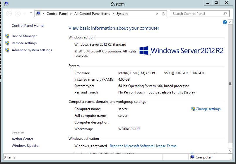

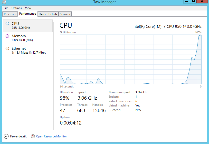

wondering if theres a setting iv missed in Bios/UEFI to allow usage of turbo boost for the CPU. it should boost up to 3.33Ghz (the Hardware was boosting when it was a single server before i changed to UnRaid. so boost is enabled.)
im utilizing all 8 threads for this VM as its the only one ill be running. Attachment shows 6 Cores (this was for testing)
Any assistance would be great.

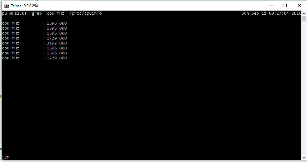

You have to look into unraid command line to see what frequency you are running. I use this to check out what's going on.
watch grep \"cpu MHz\" /proc/cpuinfo
here are the results idle and under load
Well it's definitely using boost if it's getting to 3.2GHz don't know why it wouldn't be hitting 3.3. Can you set the multiplier in the bios
