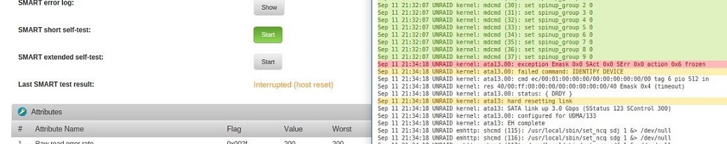

So I had a 'failed' parity drive for some time and since I haven't found the time to test it, I bought a new drive the other day. Now both seem to be displaying the same symptoms.
Both drives are WD30EFRX (3TB WD Red). I've already replaced the SATA cable, but may do so again. No other drives seem to be experiencing any issues. Not entirely sure what is going on.
New drive pre-cleared without issue, as far as I can tell. It was only after I added it to the array did it start to 'fail.' I'm not convinced this is drive-related.
  • HostReset - My most successful attempt at a SMART report via unRAID, got to 90% then 'host reset' ... :(

SMART looks fine for both disks, and from the screenshot you posted it looks more like a interface/cable error.
Try a new cable and a different controller or controller port if available.
