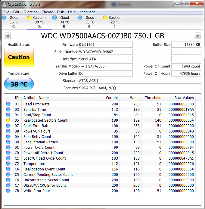

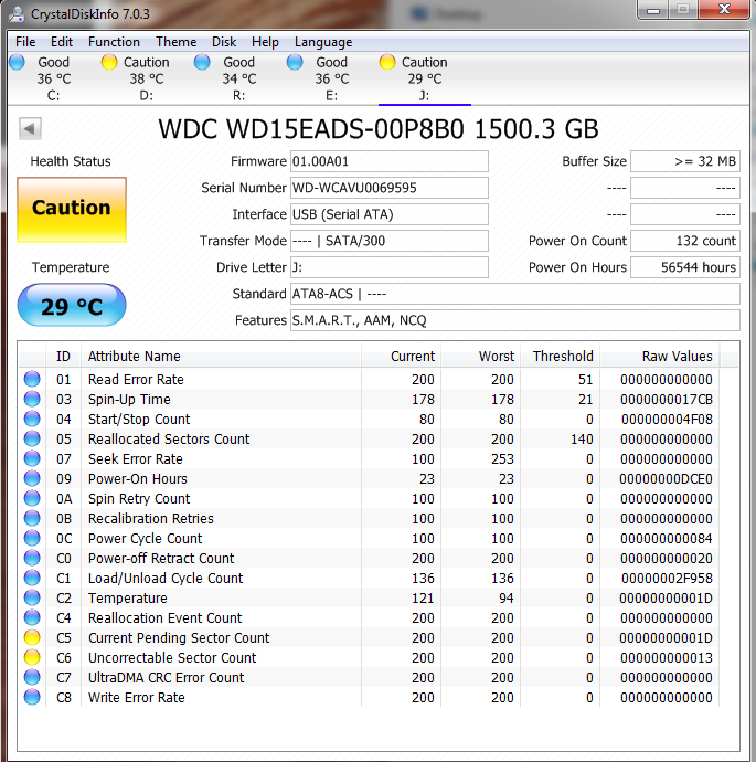

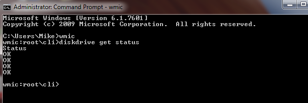

So I ran a SMART via command prompt (wmic diskdrive get status) and CrystalDiskInfo.  I have attached the reports that I got from them...I recieved a "Caution" on 2 of the disks I planned on moving to my array.  WMIC came up clean.
Can someone check the attached images and let me know if these will be OK to use in the array?  Or is there a better SMART report I can run (apart from pre-clear obviously).
Appreciate any help.
Both have issues, and considerable age.  I would not add them until you have Precleared them 2 or 3 times, and they have passed every time.
