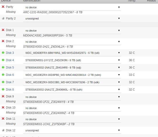

6.2 stable hammered my Acreca HBA settings. Likely due to the scsi plugin not working. Reverted back to previous version (6.2rc5) files on flash and rebooted. RC5 is working.
Dynamix - V6 Plugin "SCSI Devices (unRAID 6.2 only)" does not survive update to 6.2 stable. Plug-in disappears and disks are all unassigned.
There is an update available for Dynamix SCSI devices which installs with unRAID 6.2 stable.
