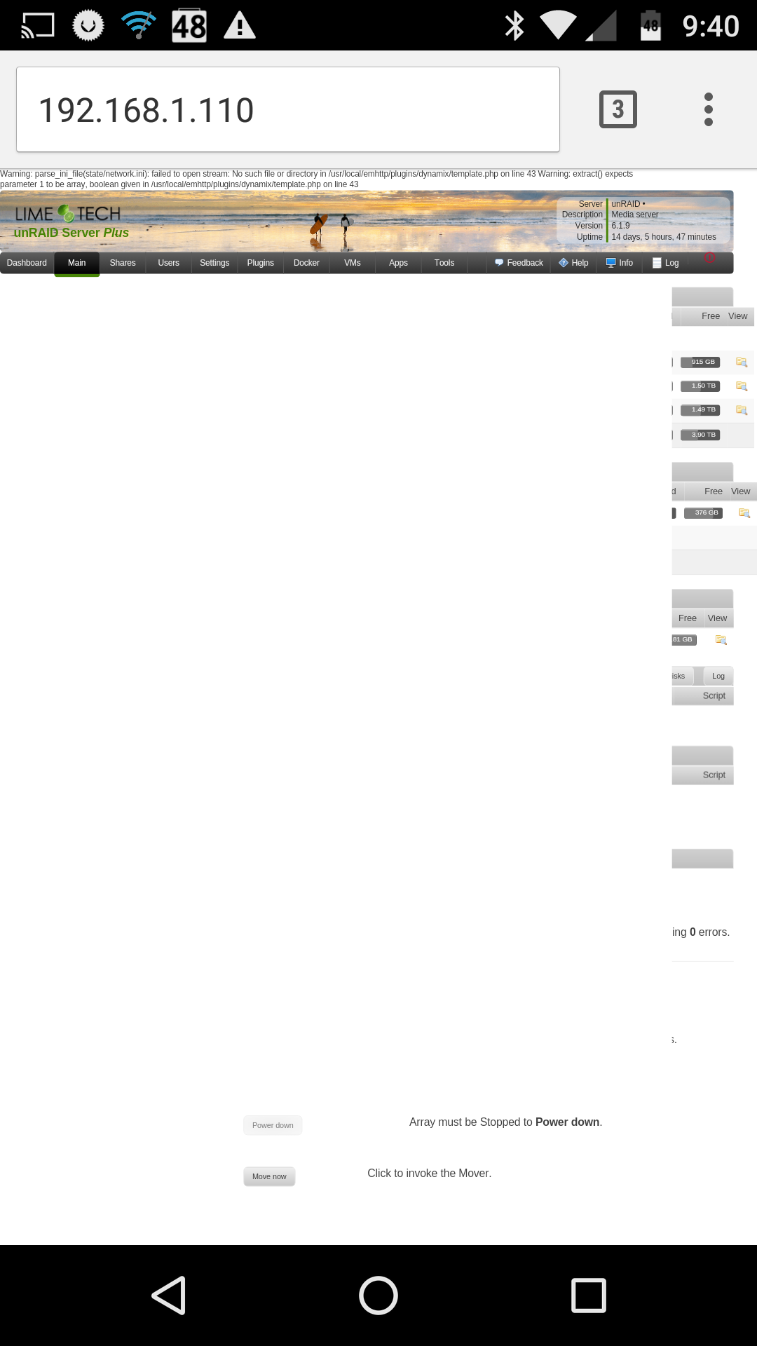

Haven't upgraded yet but today I notice the web GUI is acting up.  Is there something changed in community apps for 6.2 that is breaking 6.1.9?
Warning: parse_ini_file(state/network.ini): failed to open stream: No such file or directory in /usr/local/emhttp/plugins/dynamix/template.php on line 43 Warning: extract() expects parameter 1 to be array, boolean given in /usr/local/emhttp/plugins/dynamix/template.php on line 43
Was going to try and stop the array but it just goes forever saying retry unmounted.  How does a non updated system start doing this?
The root of the problem is dynamix.plg plugin I had the exact same issue as your in the morning.  I couldn't even do a "powerdown -r" via terminal as the system wouldn't respond and the web interface kept looping while trying to unmounted.
I end it up doing a "shutdown -r now" via terminal as I had no other choice  once the system was back up I deleted the dynamix.plg located at /config/plugins/dynamix.plg on the flashdrive then rebooted the server one more time.... GUI problem was solved. However my system initiated a parity check as soon as I started the array
You can read all about it here https://lime-technology.com/forum/index.php?topic=51891.0

Sep 17 10:29:10 Tower dhcpcd[1601]: br0: delaying IPv4 for 0.9 seconds
Sep 17 10:29:10 Tower dhcpcd[1601]: br0: using ClientID 01:00:25:90:57:9e:a8
Sep 17 10:29:10 Tower dhcpcd[1601]: br0: soliciting a DHCP lease
Sep 17 10:29:10 Tower dhcpcd[1601]: br0: sending DISCOVER (xid 0xacde3e83), next in 3.4 seconds
Sep 17 10:29:11 Tower dhcpcd[1601]: br0: offered 192.168.1.6 from 192.168.1.1
Sep 17 10:29:11 Tower dhcpcd[1601]: br0: sending REQUEST (xid 0xacde3e83), next in 4.6 seconds
Sep 17 10:29:11 Tower dhcpcd[1601]: br0: acknowledged 192.168.1.6 from 192.168.1.1
Sep 17 10:29:11 Tower dhcpcd[1601]: br0: probing for 192.168.1.6
Sep 17 10:29:11 Tower dhcpcd[1601]: br0: ARP probing 192.168.1.6 (1 of 3), next in 2.0 seconds
Sep 17 10:29:13 Tower dhcpcd[1601]: br0: ARP probing 192.168.1.6 (2 of 3), next in 1.7 seconds
Sep 17 10:29:14 Tower dhcpcd[1601]: br0: ARP probing 192.168.1.6 (3 of 3), next in 2.0 seconds
Sep 17 10:29:16 Tower dhcpcd[1601]: br0: leased 192.168.1.6 for 172800 seconds
Sep 17 10:29:16 Tower dhcpcd[1601]: br0: renew in 86400 seconds, rebind in 151200 seconds
Sep 17 10:29:16 Tower dhcpcd[1601]: br0: writing lease `/var/lib/dhcpcd/dhcpcd-br0.lease'
Sep 17 10:29:16 Tower dhcpcd[1601]: br0: adding IP address 192.168.1.6/24
Sep 17 10:29:16 Tower dhcpcd[1601]: br0: adding route to 192.168.1.0/24
Sep 17 10:29:16 Tower dhcpcd[1601]: br0: adding default route via 192.168.1.1
Sep 17 10:29:16 Tower dhcpcd[1601]: br0: executing `/lib/dhcpcd/dhcpcd-run-hooks' BOUND
Sep 17 10:29:16 Tower dhcpcd[1601]: forking to background
Sep 17 10:29:16 Tower dhcpcd[1639]: br0: ARP announcing 192.168.1.6 (1 of 2), next in 2.0 seconds
Sep 17 10:29:16 Tower dhcpcd[1601]: forked to background, child pid 1639
Br0 is the problem I believe do I need to disable the bridge?
