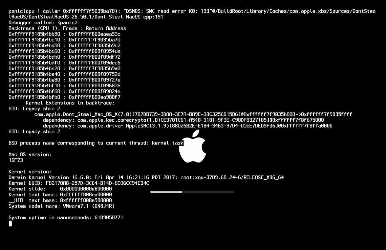

Hello Guys;
I was running without issues OS Sierra (10.12) on VMware Workstation 12 pro, after upgrade VMware Workstation I tried to power on the VM and got the error "DSMOS: SMC read error K0: 133"@/BuildRoot/Library/Caches/com.apple.xbs/Sources/DontStealMacOS/DontStealMacOS-26.50/Dont_Steal_MacOS.cpp:191
I watched the videos but it's only cover the upgrade process, in my case I am not able to power on the VM.
Any Ideas?
Regards
You do realize this is a forum for a totally different platform, right? This is the forum owned and run by Limetech for running their unraid software. You would probably get more relevant answers on a VMware forum.

I followed the guide on the latest video using my macbook pro and vmware to install everything into the vdisk then move it into unRAID but I'm stuck on the bootloop when trying to start the VM right after the Clover menu. I'm assuming it's because I screw up somewhere with the AppleSMC/OSK Key but I can't figure out what the issue is.
Here's the message I'm getting -> imgur link
And here's what my XML template looks like right now -> pastebin link
Any idea on where I might be screwing up?
Hi Yes,
I really should make a new guide from start to finish soon. You need to install the fake SMC (see the video on upgrading to 10.12.4) when you have created the VM in VMware Fusion before converting to kvm.
then you must remove the osk key part in the XML. Many people don't realise it is actually 3 lines you need to remove.

You don't just remove the  <qemu:arg value='isa-applesmc,osk=xxxxxxxxxxxxxxxxxxxxxxxxxxxxxx'/>
You must remove these 3 lines when using fake SMC.
    <qemu:arg value='-device'/>
    <qemu:arg value='-smbios'/>
Hope that helps
