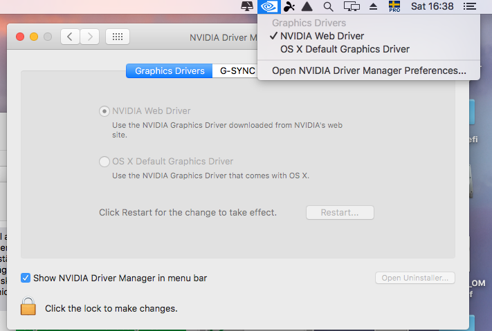

The passthrough is working, but as soon as i install the nvidia drivers and reboot, the mouse seems to be stuck in the upper left corner. Keyboard does work. Oddly enough, the mouse works when the drivers are not installed...
In clover there shall be a boot argument that shall enable use of this driver, check nvda_drv=1
EDIT
For me I was loosing HDMI sound with nvidia drivers, even if I reinstalled HDMIAudio-1.1.dmg. Back to OSX Default drivers :-)
