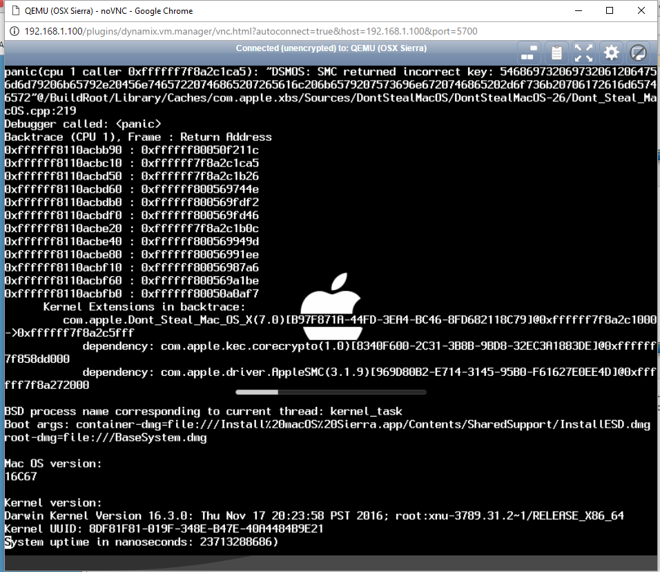

Hey guys,
I am having this error pop up at the start.  Sadly, it stops right there and reboots every single time.  No idea what I am doing wrong!
xml
http://pastebin.com/KxZLhfMC
I'm at a loss and I know for a fact i have the right osk key.  :(

Hi this is because you have not put in the osk key so this error occurs
this line in your XML should contain it
  <qemu:arg value='isa-applesmc,osk=xxxxxxxxxxxxxxxxxxxxxxxx'/>
get the osk key and put it in the part where it says xxxxxxxxxxxx
If you are not sure how to get the key please see here http://lime-technology.com/forum/index.php?topic=43816.msg519095#msg519095
After which it should work  :)

I'm a FOOL... figured it out. lol I miss typed the osk key.
