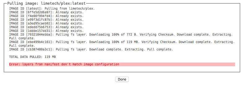

Hello,
I just updated to the latest unRaid version (6.2) and it shows that there is an update for Plex, but when I try to update I get the following error:
Error: layers from manifest don't match image configuration
Any suggestions would be greatly appreciated. Thanks!

There's an entry in the docker FAQ about this
Thank you!
Question - if 2 out of my 3 dockers updated successfully do I still need to delete the docker.img file and recreate everything or just removing the container and re-installing would work as well?
I tried it and it worked. Re-added just the docker container and now it shows it is up to date.  :)

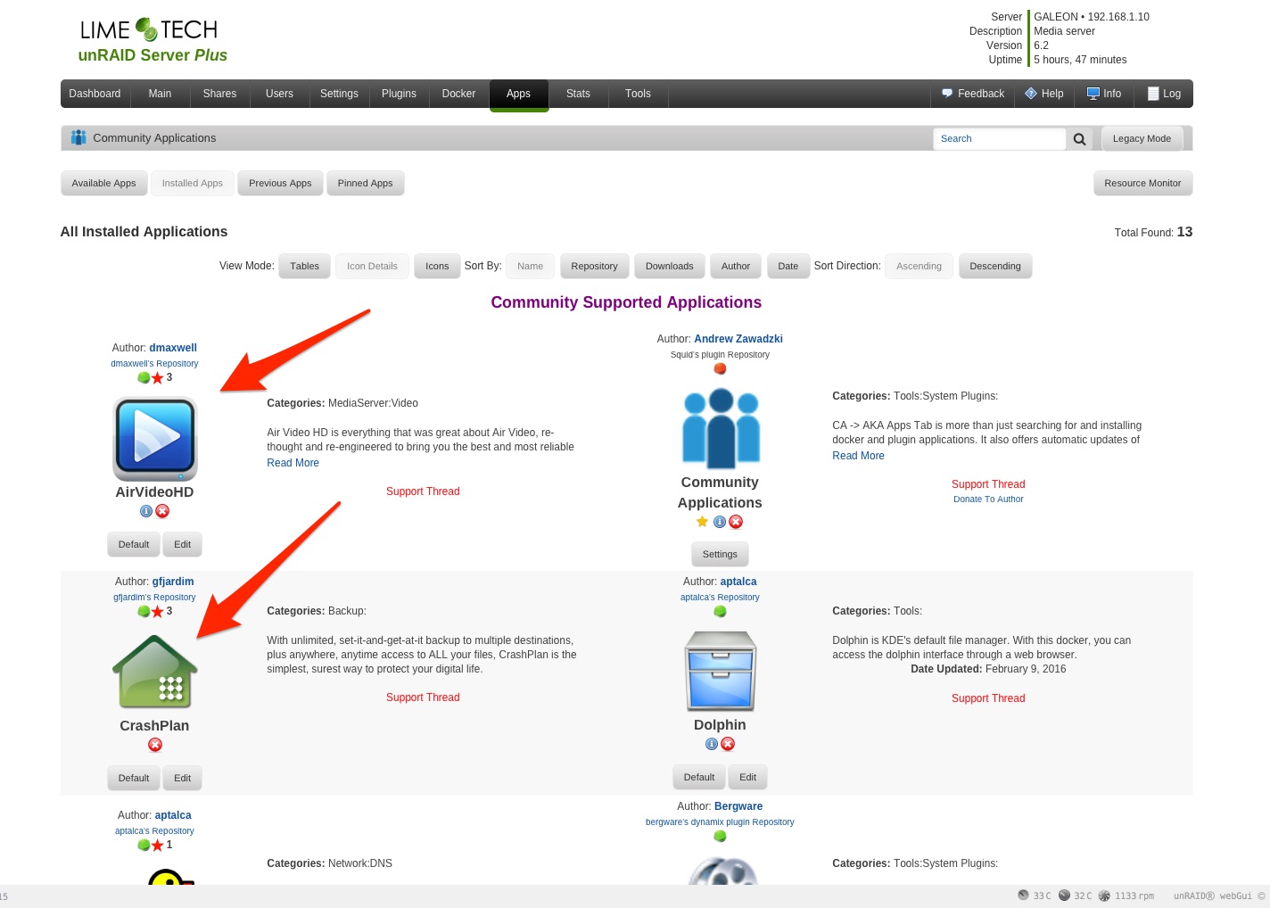

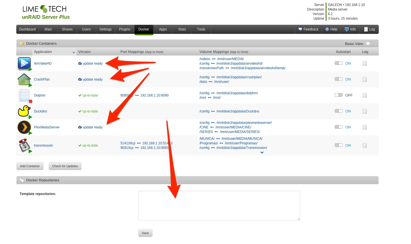

Thanks Squid! I read in another thread you recommended to delete the docker repositories, as CA manages it by itself. Right after upgrading my server to 6.2, all the dockers showed an available upgrade, but just inside the Docker tab, not inside the CA tab. Am I doing anything wrong?
It should show it in the installed apps section.  But admittedly it's been a while since I've checked that section.
Sent from my LG-D852 using Tapatalk
I can't see it :(. Here's a screenshot of my installed apps window. The two dockers marked with the arrow need to be updated (as said by the native Docker tab) :(
I also use your wonderful "Fix Common Problems" plugin. I fixed many things I had wrong, and how it's happy everywhere :) (thank you again, by the way ;) )
