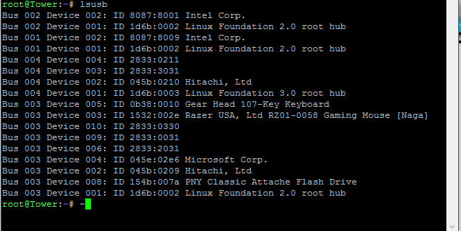

I assume it is USB thing?
Enter the console (telnet or SSH) and type
lsusb
. Copy the output here for us to read.

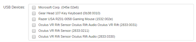

See attached! See if that helps!
Sent from my SM-G930V using Tapatalk
So you DO check the device in the VM settings or not? Did you uncheck them to make a screenshot?
I check them when I am running the VM. I just pulled one of my other VMs up so I could take the picture.
