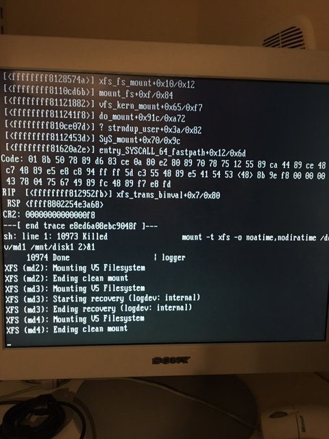

When I boot my unraid server the console screen usually stops at the IP address of my box and a login prompt.  Currently after that prompt the screen continues on after the IP with what seems to be some errors.

current boot screenshot attached.
You need to start in maintenance mode run xfs_repair on disk1.
Thanks Johnnie, any suggestions on how I run XFS_Repair?
