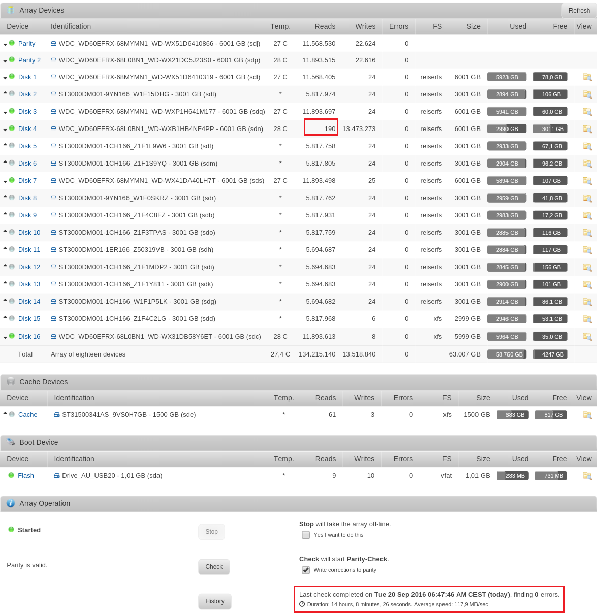

UI shows parity check completed after data rebuild
On my 6.2 double parity rig I had to replace a failing disk. The data rebuild took place and finished successfully. After the data rebuild the UI shows a successful parity check with that same date of the data rebuild.
The data disk has not been read - just written. How can this be a successful parity check?
IMHO, the UI is wrong here. A successful data rebuild has been processed, no parity check.

You're absolutely correct => this is an error.
Not only is a rebuild NOT a parity check; but you SHOULD do a parity check after the rebuild to confirm all went well.    Note that this is the ONE time I recommend doing a non-correcting check; so if anything did go awry, you can repeat the rebuild.

Yes, the history seems to be wrong as well:
2016 Sep 20 06:47:46|50906|117,9 MB/s|0

And here, in middle paragraph.  Not a rebuild but a clear after new drive added.  I added a bit of detail from the syslog, as I can see why it gets confused.
While it's not good that these events are misreported as parity checks (hopefully they'll be resolved);  remember that the first thing you should do after a rebuild is a parity check to confirm all went well => and as long as you do that, you'll indeed have a correctly annotated last check time  :)
