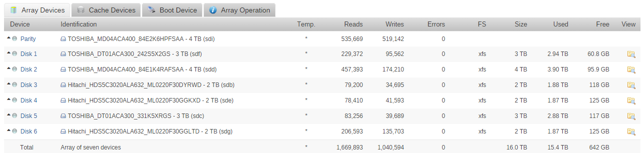

I'm wondering at what number of hard drives or at what total array size is dual parity now the preferred way to go?  I’m currently faced with my next upgrade dilemma so wondering which way is going to be the best way forward.
The array is currently a mixture of 4, 3 and 2TB disks totally 16TB’s.  Being the hoarder that I am I’m running low on space again and faced with my next upgrade.
The current case is the Fractal Define Mini which has 6 internal 3.5” bays and 2 external 5.25” bays.  The 2 5.25” bays are occupied by my ssd cache drive and 1 x 3.5” drive.

Parity TOSHIBA_MD04ACA400_84E2K6HPFSAA - 4 TB
Disk 1 TOSHIBA_DT01ACA300_242S5X2GS - 3 TB
Disk 2 TOSHIBA_MD04ACA400_84E1K4RAFSAA - 4 TB
Disk 3 Hitachi_HDS5C3020ALA632_ML0220F30DYRWD - 2 TB
Disk 4 Hitachi_HDS5C3020ALA632_ML0220F30GGKXD - 2 TB
Disk 5 TOSHIBA_DT01ACA300_331K5XRGS - 3 TB
Disk 6 Hitachi_HDS5C3020ALA632_ML0220F30GGLTD - 2 TB
