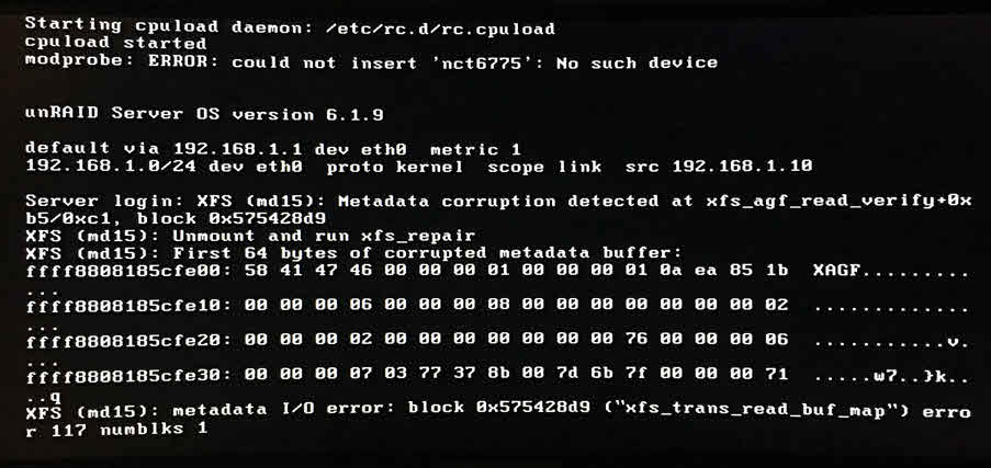

Recently upgraded to 6.2 and have been having a plethora of issues. Went to try and downgrade back to 6.1.9, and now I get an error telling me to unmount md15 and run xfs_repair on it.
I log in via Putty, can't stop SAMBA (because I think it never starts, due to corrupt metadata or something), but I can unmount drives 1-14. I type in
xfs_repair /dev/md15
...and it doesn't progress. I can Putty back into another session, but no drives are then mounted, and I'm not able to access the website pretty much as soon as I log in. Now - please understand that *I* understand I may not be doing this correctly - I'm just using Google and the Search of this forum as much as I can, and that's the command and process that I found that made the most sense.

I've added a screenshot (camera shot of my screen) of the exact error *I* get when I boot, and then of my Putty console. I can also add any log files or whatever, I think - I can access my Flash drive remotely still, at least.

If array is set to autostart disable it by editing disk.cfg on your flash drive (in the config folder):
change startArray="yes" to "no"
Then start array in maintenance mode and run xfs_repair on disk15

I had XFS errors too after the upgrade.  There's advice about this in the Additional Upgrade Advice.

Thanks once more. I was able to get the array started after fixing the drive. It's showing up as non mountable, but it seems like the filesystem isn't set to auto. I'll look into that when I get home, but if anyone knows offhand of a guide for that, I really appreciate it!
