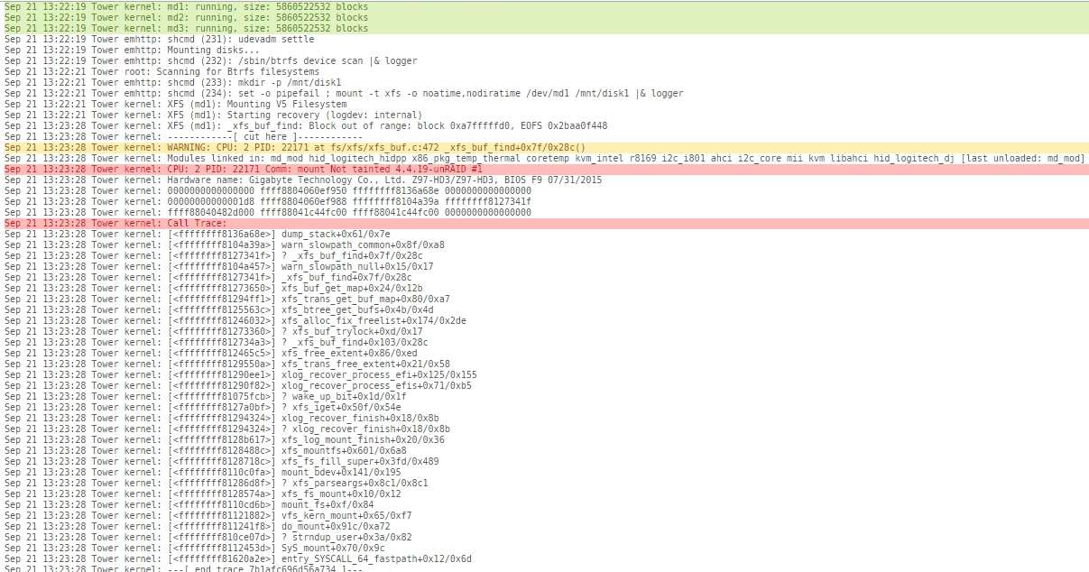

Array won't start, it sits at "mounting disks..."
I've attached what the log is showing.

unRAID crashed right after trying to mount disk1, you can see it in the log, disk1 is (md1).

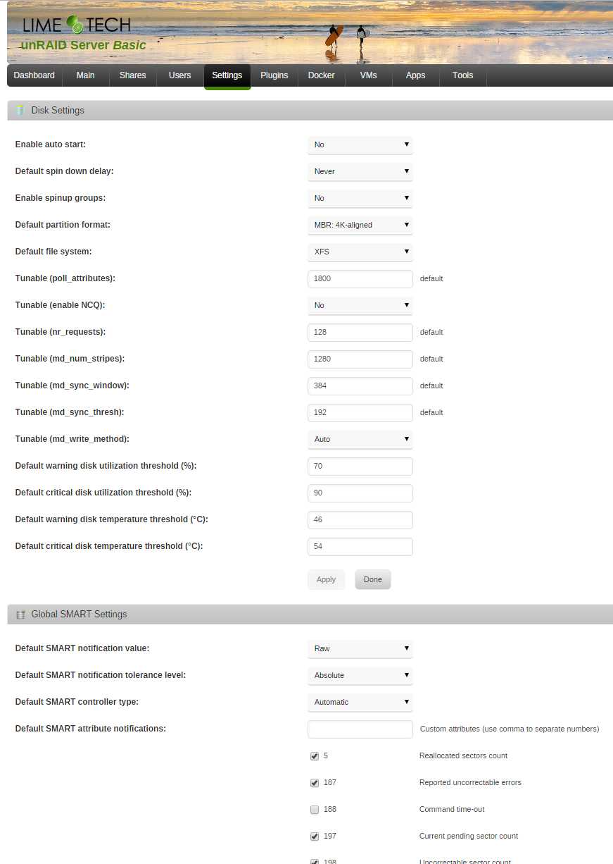

Johnnie.black I included a attachment that shows I was already on XFS, is there another place you turn XFS on?  I don't plan to add another cache drive btw.

That setting is for array disks, you have to click on the cache disk to change its filesystem, though if it's working correctly now you can leave it as is.
