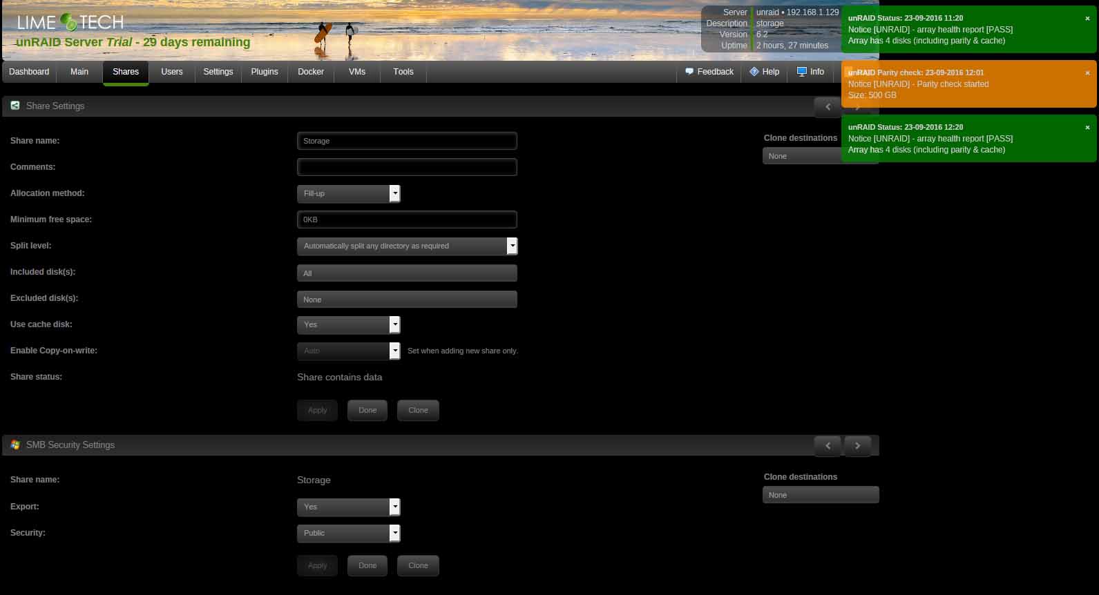

September 23, 201610 yr Author Thanks for your reply itimpi. I set it like that see the attachment. What do i wrong?
September 23, 201610 yr Community Expert What makes you think that anything is wrong? Perhaps the issue is that initially it is only writing to the first disk? If so that will because the Allocation method selected is Fill-Up. Another thing to be aware of is that in the case where there is a conflict between Allocation Method, and Split Level as to which disk is to be selected for a new file, then Split Level takes priority. You also want to set the Minimum Free Space value to be more than the largest file you will want to copy. If you do not do this, then unRAID may select a disk that does not have space for a given file and then get a failure while copying. This is a side-effect of the fact that each disk is a free-standing file system and thus files are not spanned across disks.
September 23, 201610 yr Author Thx for your reply itimpi. I change now Allocation method to High-water and it works perfect! just what i need to store much as possible storage on my box.
