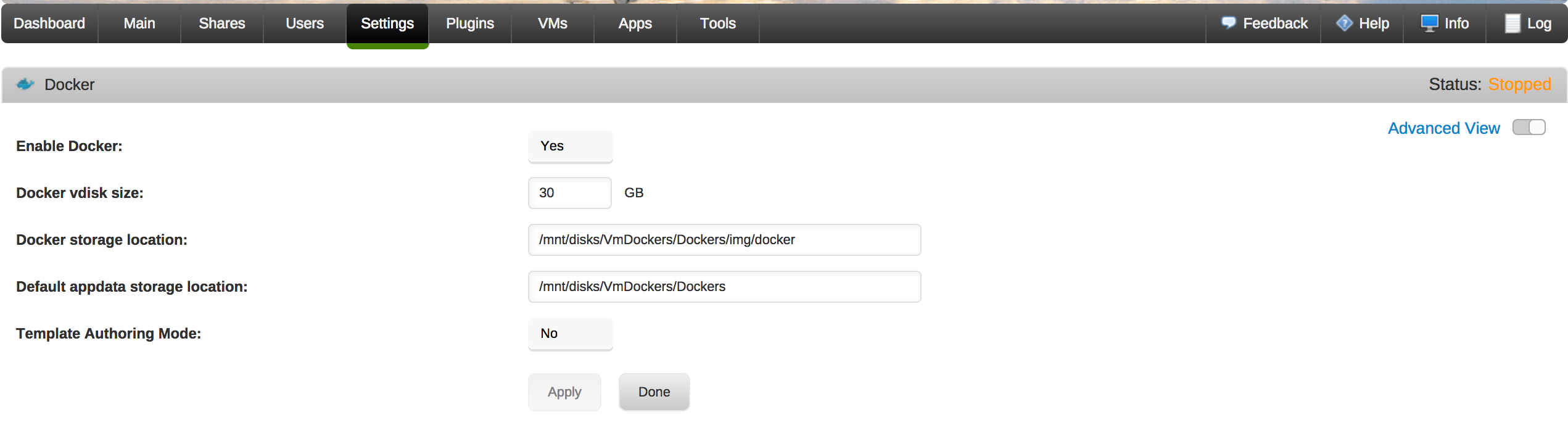

After upgrading my unraid from 6.1.9 to 6.2, I no longer have the Docker tab.
I have been poking around to find the issue but no luck.
I even delete the previous docker img to let unraid creating a new one, but nothing hapenned.
I disable and re-enable the Docker in the settings tab with no luck (I always have docker status stopped).
I just attached the diagnotics log to this post. may be someone can pinpoint the problem
thanks to everyone
unraidtower-diagnostics-20160924-1009.zip
by looking closely in the syslog.txt,
normally at line 1950 the starting of the docker (/etc/rc.d/rc.docker start |& logger) should be initiated, but the starting of the libvirt (/etc/rc.d/rc.libvirt start |& logger) is initiated before and the starting of the docker never happens.
I don't understant why that is happening.
Other users have the same issue with v6.2 and running docker on an unassigned device, it should work if you move the docker.img to your cache disk.
