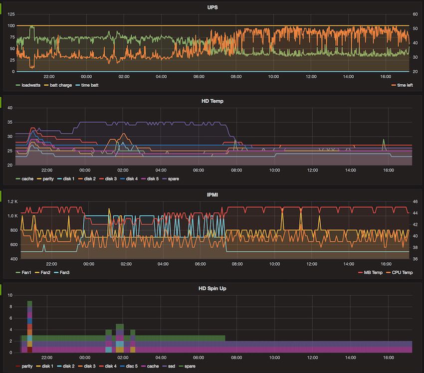

I'm sure there are better, more sophisticated ways of sending data direct to influxdb including specific php libraries, but I am not a developer, so I had to keep it simple.
So you just need a script to parse the data for measurementName, tagName and value and send it with the curl command. Simples!
The graphs can be generated in Grafana in just the same way as the graphs from telegraf (if you stick to sending the data to the telegraf database in influxdb). Otherwise you will need to set up another datasource in grafana which complicates this a little, but can be done.

Grafana does not need any specific setup to show this metric since it is a simple value. The measurement HDTemp will appear in the list of measurements to select.

Grafana setup
I have this set up as a stacked bar chart in grafana.
The query for each device reads as follows in the Metrics tab:
FROM default HDSpin WHERE +
SELECT field(/dev/sde) sum() +
GROUP BY time(1m) +
ALIAS BY disc name Format as Time Series
At the bottom I have :
Group by time interval >60s
The display tab has
Draw Mode
Bars checked
Stacking and Null value
Stack checked
Hover info
Stacked value individual

Grafana does not need any specific setup to show this metric since it is a simple value. The measurement IPMI will appear in the list of measurements to select.
To show fan speed and temp on the same graph, move the temps to the right axis and the fans to the left axis.

Nothing special in grafana for this since they are simple values returned. I modified the LOADPCT by multiplying it with the rated capacity of my unit to get the power in watts.

Disk 4 and 5 just finished their file integrity check.  I also have a hole every day at 11:36-12:36 that I haven't yet figured out why.  I'll need to investigate that but I dont think its related to these scripts.
If anyone wants the grafana json just let me know I can post it as well.
Please post any suggestions of other metrics to capture.
