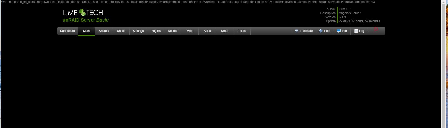

Webgui warning preventing page loading
Hi - The webgui isn't displaying due to a warning I am receiving. Anyone have some input?
Thanks,
Angelo
Thanks @Squid, that worked. However, I'm now unable to start my Windows 10 VM.

First thing to do is to do plugins - check for updates, and install the dynamix webUI update available and then try the VM again

Interestingly enough, the dynamic webUI is already up-to-date..
Shouldn't be, as you've reverted to the stock UI that comes with 6.1.9, and there are updates available.
