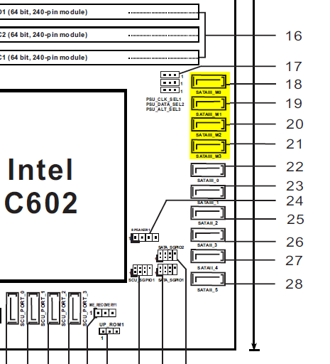

I would avoid the Marvel 9230 controller that is built into the MB.  Just use the other 10 connectors and avoid those 4 on the Marvel.  I passed mine to a VM but even then the controller will drop the drives periodically (every 2-3 weeks).
I guess I'm confused and I can't tell from the guide, are there 4 Marvell ports or 8 and is there an easy way to distinguish them by looking?
There are only 4 on my EP2C602-4L/D16.  I'll look in the manual as it was hard to tell and I got mine backwards the first time.  If I remember correctly they are the four ports right next to the 2 6GB MB ports at the back of the MB.  I expected them to be the 4 separate from the others along the side but those were the 3GB MB connectors.  Just like I would figure the dedicated IPMI lan port is the one separate from the other 4 lan ports - but it isn't.  Very confusing in my opinion :o
Actually it was where I said but there were 6 other connectors not two.  See the graphics.  One graphic lists the number of the port on the MB and the other highlights the ports on the MB itself.
OMG you may have just fixed another problem of mine about the ICMI port... I have all 3 disks plugged into the top 3 ports on the right hand side but if you could somehow confirm I'd really appreciate it. Did you have problems with the Marvell chipset? I'm running 1.80 which I believe to be the latest firmware for the board.

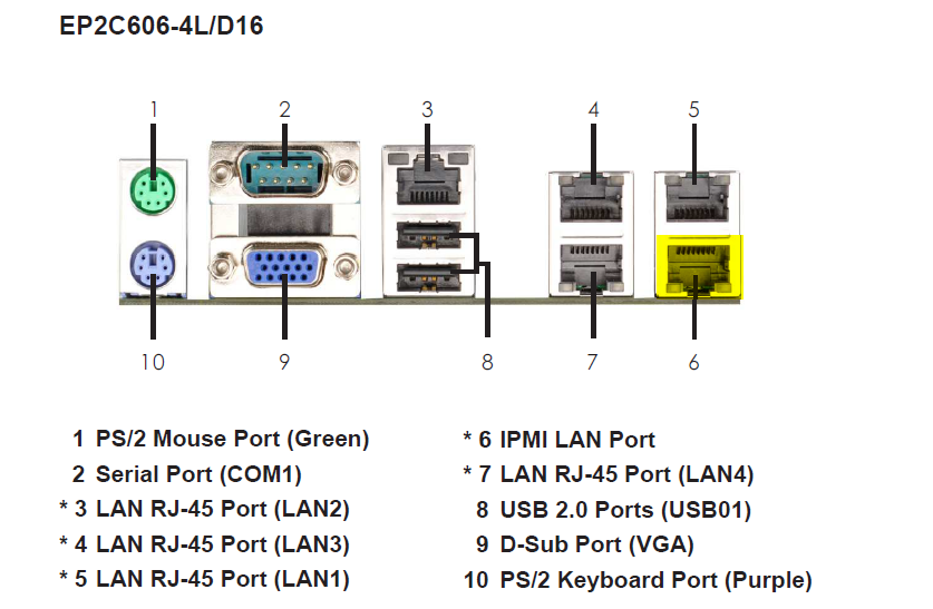

I never upgraded mine as it looked like it was the lates on the ASRock site.  But I've always been meaning to upgrade it anyway just incase just haven't had time.  Attached graphic shows highlighted dedicated IPMI port.  Note you can share the IPMI with a regular lan port but you cannot use the IPMI port as a lan port.  Not sure why they did that except maybe to reduce the number of network connections by one.
That definitely explains my network issue, thanks for that! If I can figure out the Marvell/Intel ports I'll be ready to move the disks (still copying off data). You'd think they'd have this documented in a similar kind of picture but I can't find one.

You did see my previous post where I edited and added graphics for the Marvel ports?
I didn't! You are freaking awesome and those are the ports I'm using as well which explains a lot. Thanks so much for your help with this! I'm hoping to have my data off and ready to try again by tomorrow. I'm blowing away everything because I'm also having weird folders that I have no access to and can't delete, probably corrupted during the crash.
