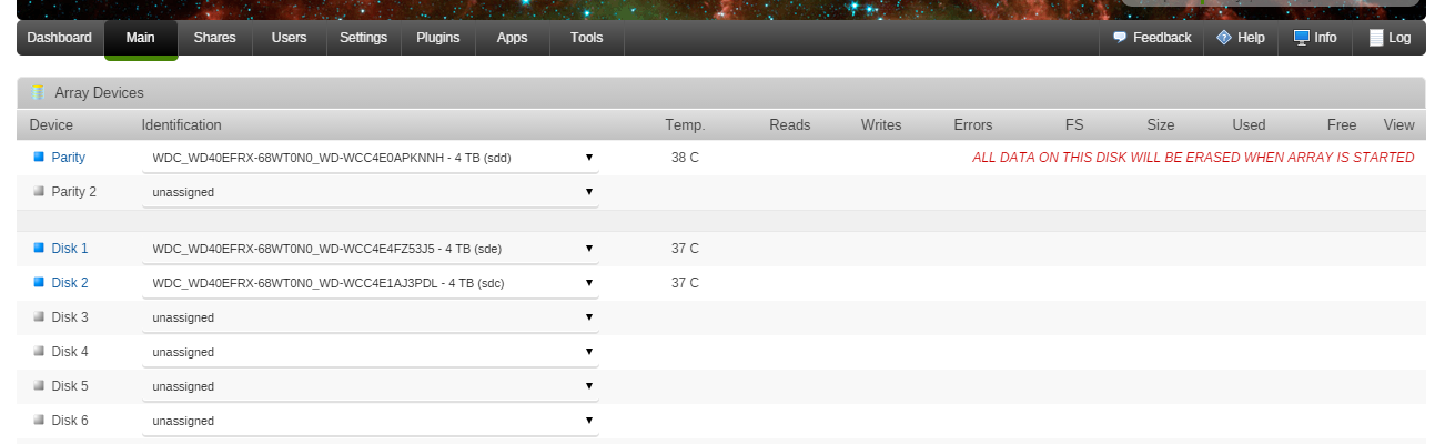

At step 7. When I am supposed to reassign the disks except disk C as I want to get rid off.
But when I assign my parity disk a huge red text says "ALL DATA ON THIS DISK WILL BE ERASED WHEN ARRAY IS STARTED".
This is before new config

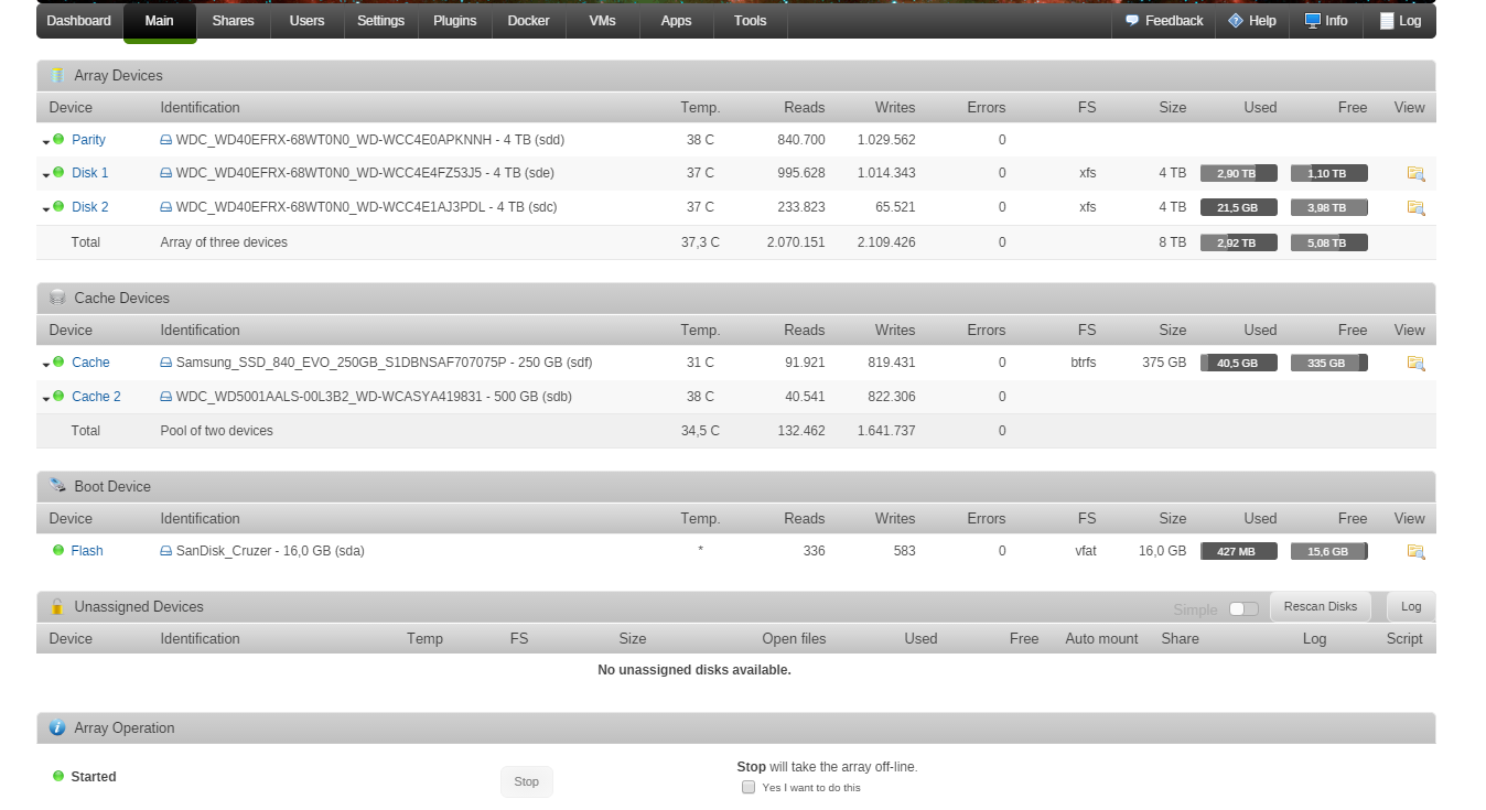

This is now
What shall I do??

I think the warning was added to try and protect against folks accidentally assigning the wrong disk to the parity slot -- unfortunately that seems to happen quite a bit.    Better to have you ask about it and confirm it's okay than to not have the warning and wipe out all of the data on a data disk you incorrectly assigned as parity  :)
