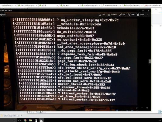

today I notice that a fair chunk of files were missing. Check the logs and xfs errors appear to be the issue. I find a couple of threads here and attempt to diagnose. Get my syslog off and a diagnostic finally downloaded. Follow the instructions to repair the xfs on disk5 which appears to be the one with the issues. Mount in maintenance mode and run xfs_repair -nv via the GUI as instructed. First run didn't give any instructions like I was expecting so ran a second time with no parameters to repair. It states to try mounting the disk first because some data may be lost if I don't. Server hard locks upon trying to mount and every subsequent attempt at booting. Eventually remove the disk5 from the system and it boots without mounting the array. Everything looks ok so decide to mount the array without the drive and just work off the parity and check that everything is intact. Server hard locks again with the attached output to screen. System diagnostics from the original issue attached.
At the moment it looks like I have lost everything. I can't boot unraid in any way that allows me to interact with the drives :(

attached screen shot. File size was too large to post
