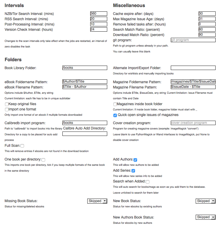

If I understand how LazyLibrarian works, you can have it play nice with Calibre. Some further details here in the LL Wiki.
I want to fill in the field under Settings-->Processing-->Calibre Import Program
The Wiki says:
Calibredb import program
If you use Calibre and LazyLibrarian on the same machine and they share the same books, put the full pathname of your calibredb program here, or just calibredb if it's in your system path. LazyLibrarian will not import the books, it will ask Calibre to import the books and then update the LazyLibrarian database to match.
As these are dockers, I do not think there is an actual calibredb binary with a path? What would one fill in here to have Calibre do the processing?
Would /opt/calibre/calibredb work? I would think the dockers are isolated from each other? Or would you use the docker CLI in this field?
The other alternative is to use this option:
Calibre Auto Add
If you use Calibre on a different machine, or want to maintain separate LazyLibrarian and Calibre libraries, complete this to have LazyLibrarian downloaded books added into the Calibre library. Set Calibre to watch this directory for new books arriving. This should not be used if your LazyLibrarian base destination folder is already an existing Calibre library or you will end up with two copies of each book. See calibredb option above.
Recommendations or thoughts from folks? Anyone else using LL with Calibre?

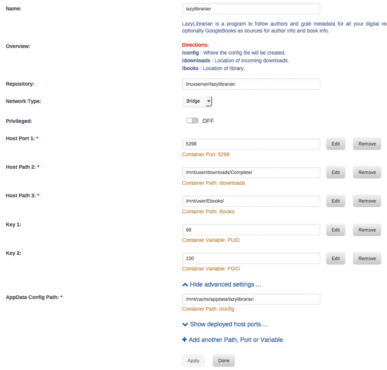

I am see lots of these errors today, I just started using LL again. I performed a clean install and I am still getting these errors:
07-Apr-2017 11:30:20 - DEBUG :: ADDAUTHOR : getBookCover: Error getting google image https://encrypted-tbn2.gstatic.com/images?q=tbn:ANd9GcTCd0uboozGJHnCgHgmgK2QVgTXVBV_h96PHv9lziS4Mxt84VN9FHqozjaK, [[Errno 2] No such file or directory: '/config/cache/book/18742609.jpg']
Screenshot of my LL setup attached.
@ice pube Try changing /mnt/user/appdata/lazylibrarian to /mnt/cache/appdata/lazylibrarian
If that doesn't work then looks like an issue pulling images from google.
That seems to have worked, thanks.

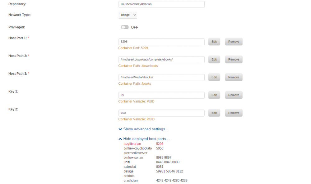

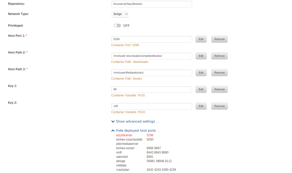

Hi.  Can I request some help running this app?  Installed, and reinstalled several times already, but everytime I start, I don't get to the web interface. I tried changing port number already as well.  I also tried deleting the container itself.  I'm attaching screenshot of logs.
I think its probably your docker settings for this we need to see
Is this it?ll.thumb.png.a26cf7651a8c298ca6d271cfd4f3051a.pngll.thumb.png.ed8765646d7d9bb02f299f4447a9b2fd.png
and you see nothing at http://192.168.1.103:5296 ???   I notice you changed the default port but that should not matter. Do both those paths exist? The docker IS started? I wonder also if your creation & deletion has not been done cleanly? Have you checked? Are there any orphan docker images? Check inside of /mnt/user/appdata/ ??
No point me posting my config as I have diff ports, and a reverse proxied LL so it will just confuse.
Hi, yes, I see nothing.  Reason I changed port is because I've installed in the default port before, and it showed up blank.  I have several other dockers running, working perfectly.  I changed port because I'm afraid there might be orphaned containers left.  But I also gave it a quick check, and no orphaned containers left.  I also deleted the old docker container and created the docker container from scratch. Meaning, I didn't re-use the "my-lazylibrarian" instead, I deleted that, and created another one.
