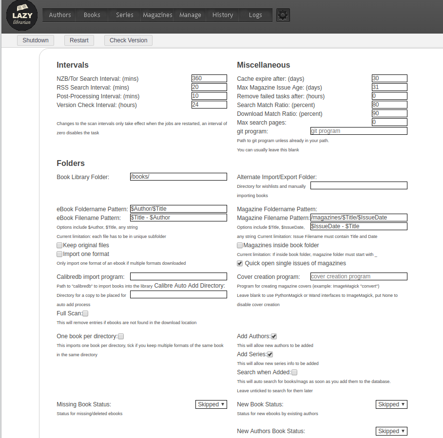

Post a screenshot of your post-process webui
Edited by jrdnlc
Same as yours.  All I did was use /magazines/$Title/$IssueDate

Doesn't look the same that's why I asked to post screenshot.

It's exactly like I said.  And I think that's a bit of a cheek seeing as I've had to drag the information out of you.
