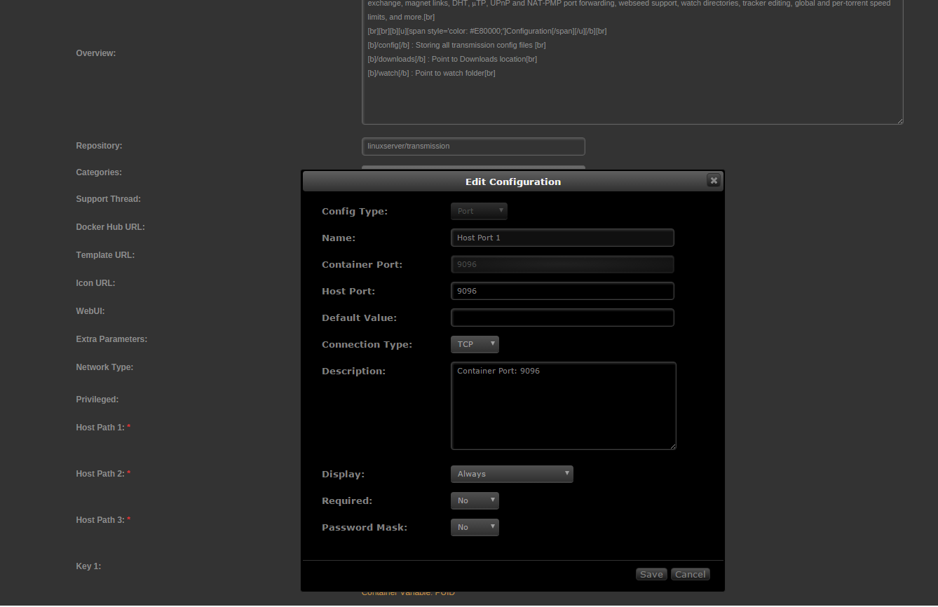

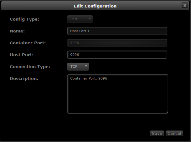

I have added some screens. The first is the one I get now where I can't edit ports (note the greyed out window).
And the second is the one where I create new ports and delete old ones like I have to do now.
Generally there's no need to edit container ports, only host ports but I guess if you're using transmission then I can see why you might have to.  Have you tried going to settings ==> docker and turning on template authoring mode?
Was just checking that option out and thinking if it would do it for me. :) I'll check...
Edit: Nope. Doesn't work.

Apparently, you have to remove that config and add another one with the port you desire. Once you add a configuration, the container value becomes immutable.

Yeah that's what I have been doing now. Shame... I was hoping that there was a simpler way (was hoping for a toggle I've missed somewhere).

Most of the time you need to change the host port but not the container port.  There have been a lot of support requests from people who change both ports and don't understand why they can't access the container.  This completely prevents that issue.  For the very rare time when you really do want to change the container port, all you have to do is hit the Remove button and then Add a new one. Overall a pretty good solution.
