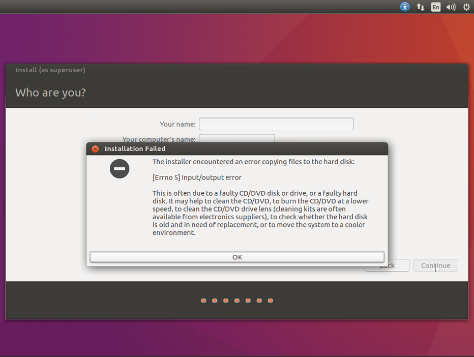

I am a new unRAID user.  I have 6.2 up and running, a few dockers installed, and decided to try to set up a VM.  I have now tried and failed three times—first two times with separate downloads of Linux MINT 18 and the third time with Ubuntu 16 LTS.
I can create the VM, start it, and VNC in.  I can get the live image up and running and start the installer.  Each time, though, the installer will crash with a complaint about CD/DVD read errors.  Given that I am installing an ISO from a virtual (SATA) drive, I find the suggested solution, namely cleaning the physical disc, to be less than helpful.
Any ideas?
Thanks!
This is what keeps happening.
Have you tried burning the ISO onto a disk and trying it on a bare metal machine?  IE: is the ISO corrupted?
Are you getting any read errors on the drive the image is stored on?  Posting the diagnostics might also be helpful.
