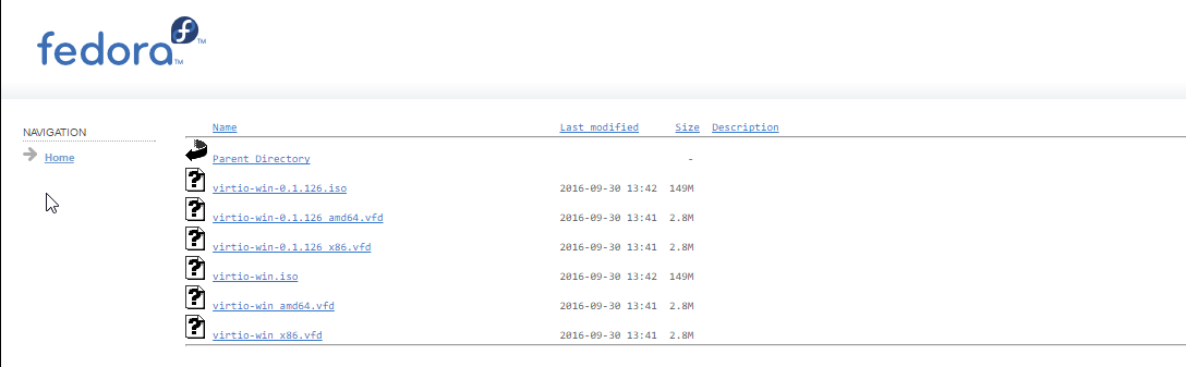

The Fedora site has VirtIO drivers at release 0.1.126 and unRAID is only showing 0.1.102.  I am going to download the 126 manually and try those as the highest the 102 version goes is Windows 8.1, which most people have been using with no issue.

I had to downgrade to 6.1.9 again so the VM settings page does have the latest version listed automatically but I didnt have the option for 118-2 when I was on 6.2.  So regardless, I just updated the VirtIO Ethernet Driver to the 126 version from the Fedora site and it site doesn't show up as listening after a restart even.  Something must be corrupt with the RDP service.  I have had Windows installs act up with weird bugs and glitches in the past like this so thats the main reason I am leaning towards that.

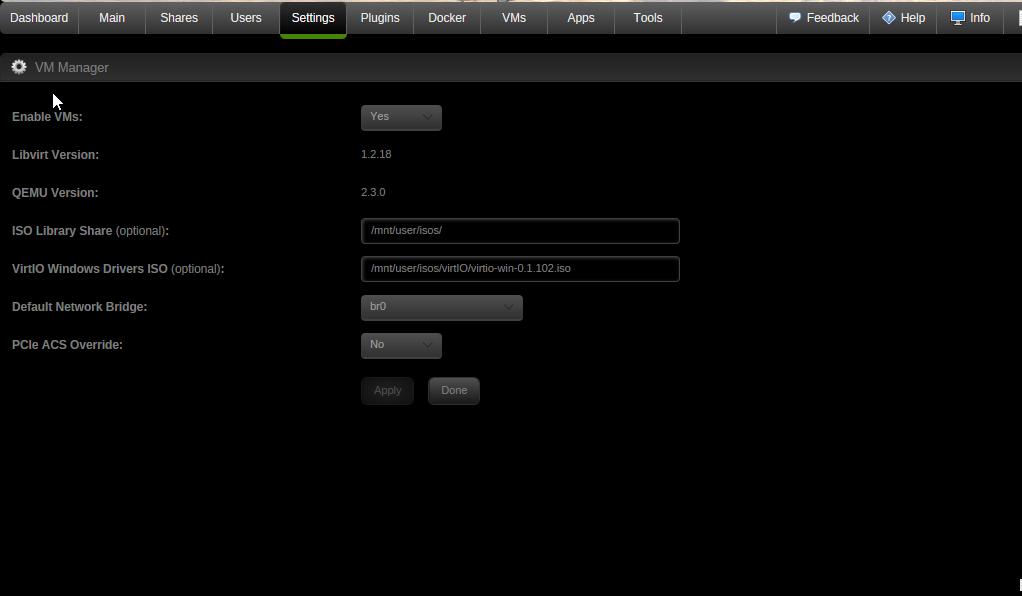

I created both VM's after the downgrade as I had some disk errors prior to and unrelated to the 6.2 upgrade.  These are both fresh installs with no errors when running slmrg in either of them.  The VM settings page displays the same thing in both Edge and Chrome, see attachment.

WTF? Ok something is definitely not right here...
Picture is my server (6.2), compare the Libvirt and QEMU versions.

He downgraded to 6.1.9, so no wonder it's old versions of libvirt and qemu.

OP please upgrade back to 6.2 and check if your VM settings look like in my screenshot.
