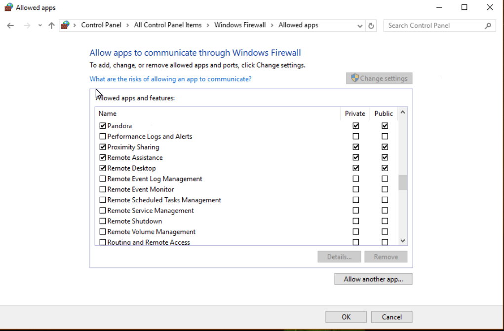

Are your settings exactly like this (screenshots)?
Open "allow an app through Windows Firewall" and allow "Remote Desktop" (private and public networks) http://i.imgur.com/vJ3W2rr.png. Also open "Allow remote access to your computer" and enable RDP http://i.imgur.com/0msIWNL.png. With these settings it shouldn't matter if the network is public or private, if it still doesn't work try reinstalling the VirtIO drivers.
Yes, Remote Desktop is enabled to go through the firewall just like your screenshots show.  But I have the firewall turned off currently to rule that out regardless.

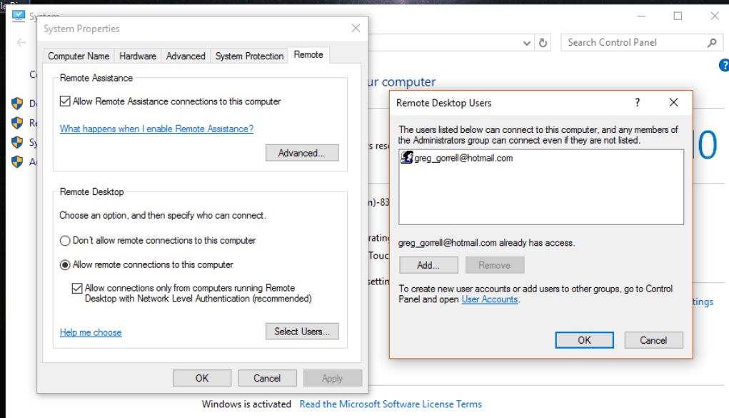

Do you use these settings for RDP?
And how does the "Remote Desktop Users" window look on your system, does it say that "[YOUR USERNAME] already has access"?
I am 99% sure that there is a problem with the RDP or firewall configuration.

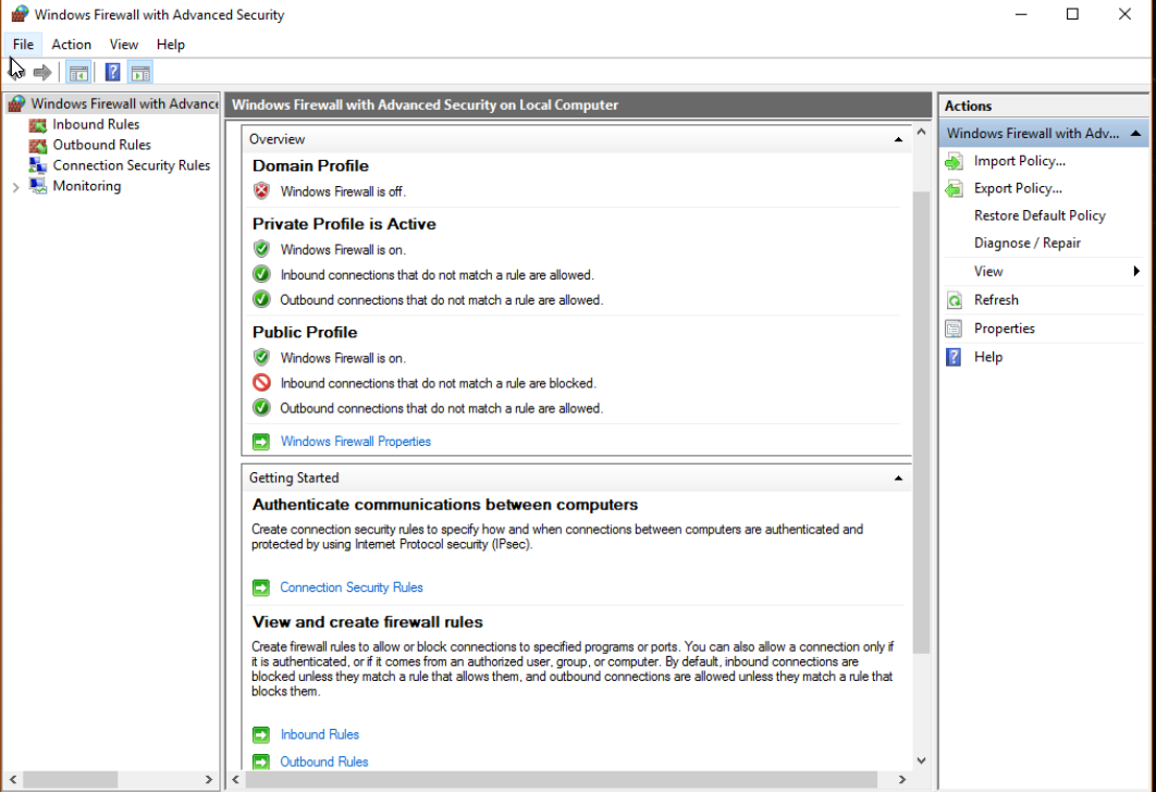

EDIT: Are inbound connections on all profiles allowed in the Windows Firewall with Advanced Security?
I am leaning towards the problem with RDP.

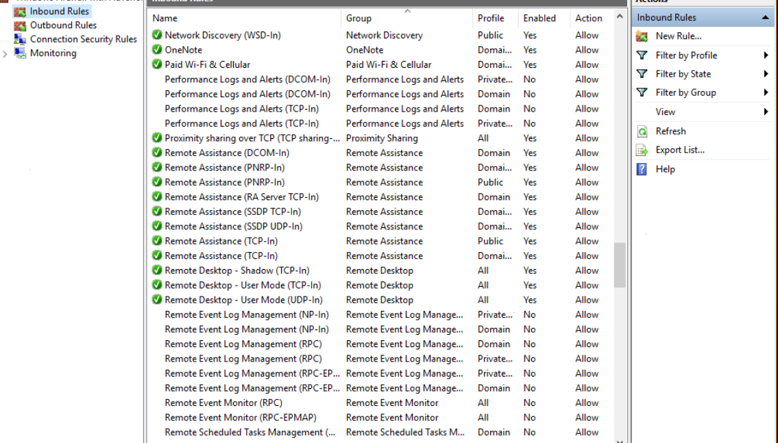

Heres some screenshots.
Open ports
Yeah, everything looks good in the firewall.
Try temporarily allowing all public inbound connections as well and reboot the VM.
