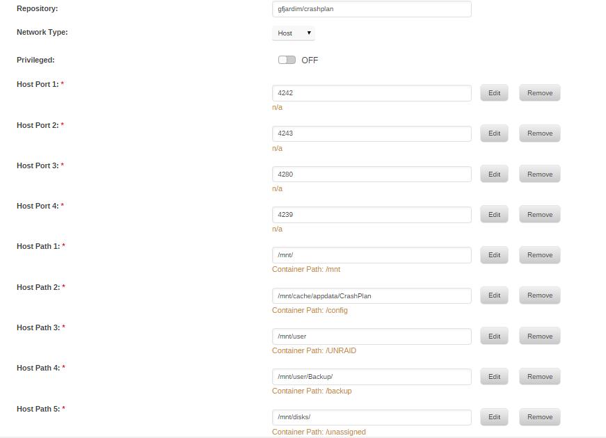

October 2, 201610 yr In 6.2, you can modify volume mountings to use the new "slave" option. What is this and how do you do it? I am getting warning from the "fix common plug ins" for CrashPlan and cannot figure out what to do. "Docker application CrashPlan has volumes being passed that are mounted by Unassigned Devices, but they are not mounted with the slave option" "To help with a trouble free experience with this application, you need to pass any volumes mounted with Unassigned Devices using the slave option. Fix it here: Docker" "Fix it here" takes me to the Docker section but I do not know what to do? Thanks! Edited May 1, 20188 yr by TexasDave

October 3, 201610 yr Author Hi Squid - thanks for helping me. I do not understand what you mean by "UD Path". I attach a screenshot of the docker setup. Can you advise which path to change please? Thanks!
October 3, 201610 yr Host path 5 (/mnt/disks) has to be set to slave mode for it to work consistently (Because you're referencing /mnt/disks which is the path that Unassigned Devices uses). Edit that path and set the mode to be RW,slave
April 25, 20188 yr Thank you. I was getting the same error for the Krusader docker. I was staring at the information for the past 2 days trying to figure out what it wanted me to change. Changed /mnt/disks/ to RW Slave (it was RW prior) and the error went away. Sometimes things are as intuitive as some people think they are and we just need a slap on the back of th head. Tim
