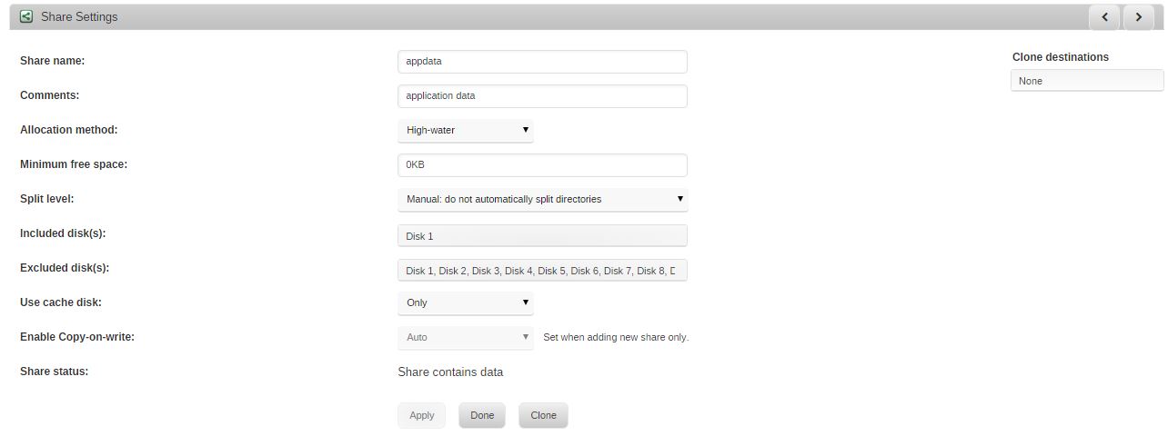

Appdata share settings:
All disks are in the excluded list
only disk 1 is in the included list.  It won't let me have none on this list.    Disk 1 is also excluded.
Use cache disk is set to "Only" as told.  I'm assuming this over-rides the above, but just being sure.
See attached image.
Parity rebuild underway.
You should never set both include and exclude. There is never any need, anything you intend can be accomplished by setting one or the other.
Include means "only these disks", exclude means "except these disks", and setting neither allows all disks, except in the case of cache-only, which means cache-only.
For you case clear both and just use cache-only.

Interesting, never heard to not set both.  All of my other shares are set up that way.
If you don't check any boxes, I think it's all defaulted to utilizing all disks.  You can "exclude all" but you can not "include none."
Anyway, I'll go with the settings you said.  Thanks again.
