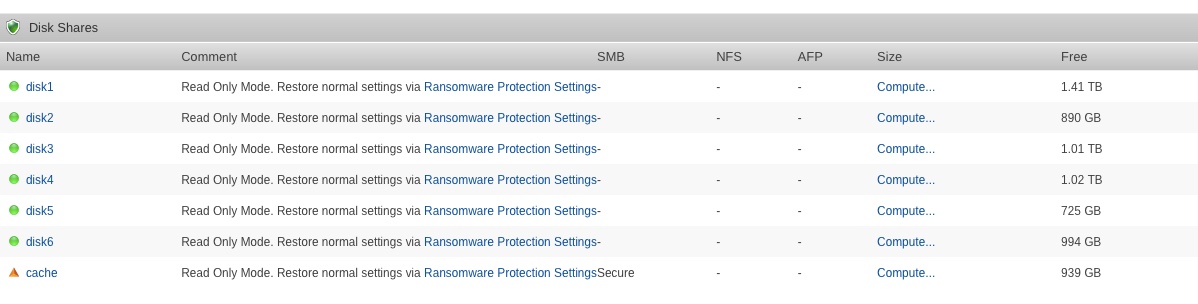

When triggering this, it has also made all the disk shares read only, including the cache share. That can't be right? How do I make at least the cache share writeable?
Just restore smb permissions. There may still be an issue where the comment says it's not writeable but it still is.

How do I restore SMB permissions? The plugin didn't do it when I "OK"'d the ransom activation, My server is kinda borked now. :-)

As soon as you go into the settings for Ransomware, there's a button that says Restore SMB permissions
I know. It didn't work! :D o.O
It has given me a prompt to tidy up my shares, so I've done that and am exporting my SMB disk shares as hidden and secure. In theory, ransomware could find the disk shares, but I think they're reasonably protected?
Edited by neilt0
I know. It didn't work! [emoji3] [emoji57]
I'd have to see the diagnostics before you reboot to try and see what went wrong. After that you can reset the permissions manually on the shares tab.

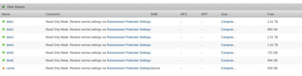

My Disk shares say Read Only Mode, is that correct?  If not how do I fix it?  Thanks
