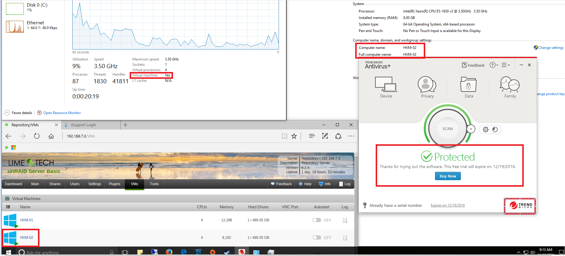

Trend Micro has a trial version you could try, I have not tried the trial version but it may work for you but it does look to be a different version then the one I am using. If I get time I will create another VM and install the trial version of Trend Micro to see if I have any issues with it.
I just tested the trial version of Trend Micro on my 2nd VM and I had no issues installing it if anyone is still looking for anti virus to use. I am using Windows 10 so I don't know if there is an issue with Win 8 or 7.
