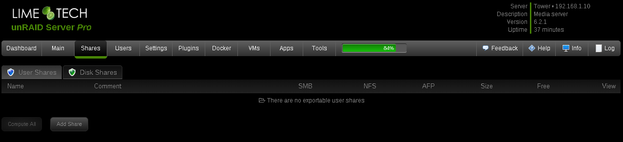

im afraid there are no shares to browse once its in this state (see attached screenshot), also see a dir listing of /mnt, note the fact it does show /mnt/user but its not accessible (second screenshot).
