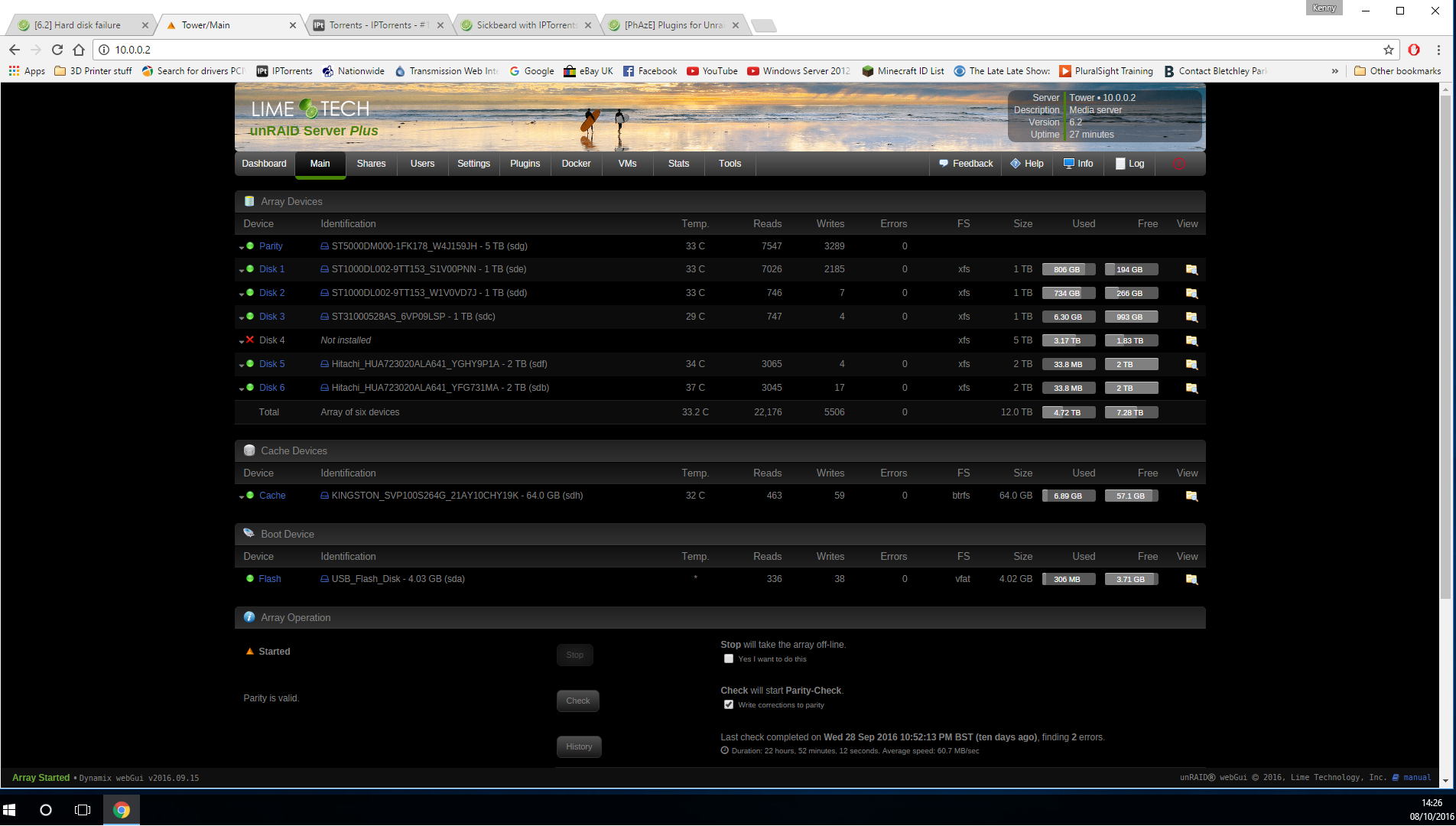

Post a screenshot of Main
here you go

just to let you guys know, i ran half of the 5tb and no issues where shown during the HDD Repair thing. seen the comment about disk 3 above so ran it on that, got to 50% and no errors on that so i decided ot plug the drive in and give it another go. booted up to unraid and checked the main screen, it said disk 4 the 5tb one was now being seen by unraid but disk 3 was disconnected so i powered down the server and checked the wires and yup, the power cable had come loose from disk 3. connected it and powered on, disk 3 was seen but disk 4 was not "again....."
realised that between the initial checks that i had done after the server fell i had added a cache drive. so i disconnected the cache drive and powered on the server..... all up and running fine and now doing a parity check / rebuild.
it says it has 1 day left of the rebuild so fingers crossed.
