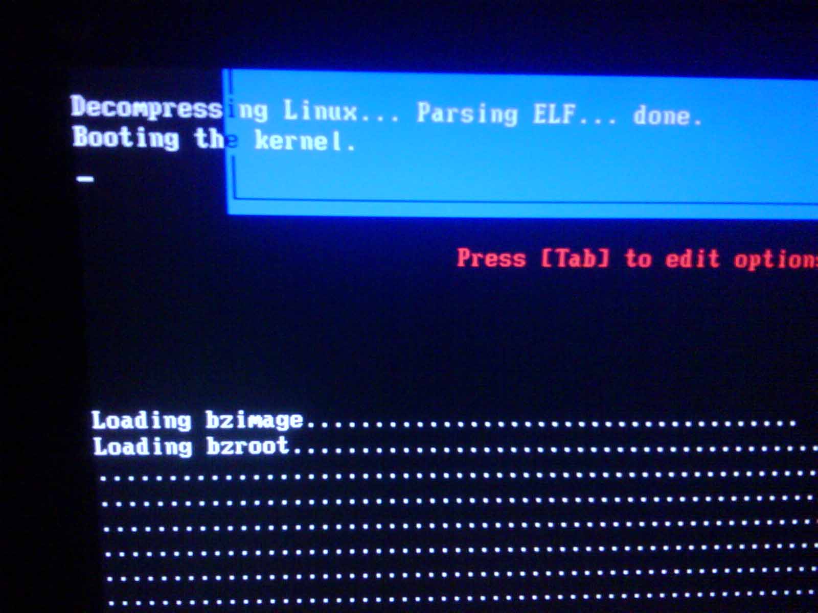

Hello everyone. I am having some trouble booting unraid 4.5.1, and I would like some help, if you guys don't mind.
I am trying to boot off my Supermicro PDSME+, and it hangs after it finishes loading bzimage and bzroot.
It says decompressing Linux, and then hangs on booting the kernel.
I have tried changing every bios option I can think of.
Has anyone else had this problem?
Attached is an image of the screen.
Thanks everyone.

when editing syslinux.cfg with those "boot codes", do I replace the append initrd=bzroot line with something like append initrd=bzroot rootdelay=10 acpi=off nolapic noapic ?
Yes... although you may not need all of those extra boot codes.  If it works with all, try to remove as many as possible of the ones you added to get to the one you actually enabled the complete boot.

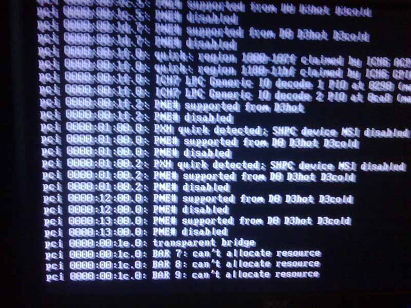

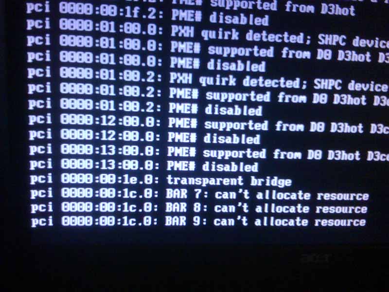

well, running syslinux again, with the new version of syslinux 3.84 allowed it to get past the point it was hanging at before, but now it appears to be stopping with some PCI problems..
pic2

every time it shows the same symptoms.. the same cant allocate resource error.

As far as "Can't allocate resource"  I found this post on Google: http://linux.derkeiler.com/Mailing-Lists/Kernel/2009-02/msg10458.html
It suggests adding
pci=assign-busses
to the boot line in syslinux.cfg
It would then look like this:

I tried both of the commands referenced in that link, the assign bus and norom, and neither had any luck.
