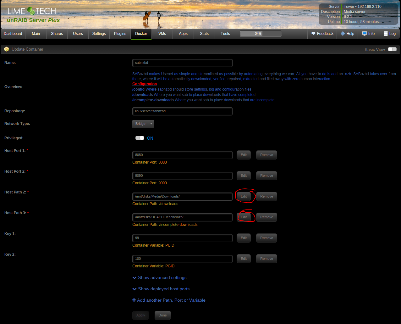

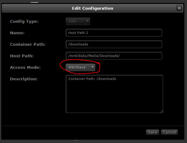

Thank you for your quick reply.
Upgrading to unraid 6.21 worked with movuing the image of the docker, perfect  :)
Can;t quite understand what you mean with the edit container comment.. what should i do exactly? And why is this not enabled at default?
Thank again!
Solved.
For the other noobs like me out there, I added 2 snips.
Thanks Squid for your patience with me :-)
