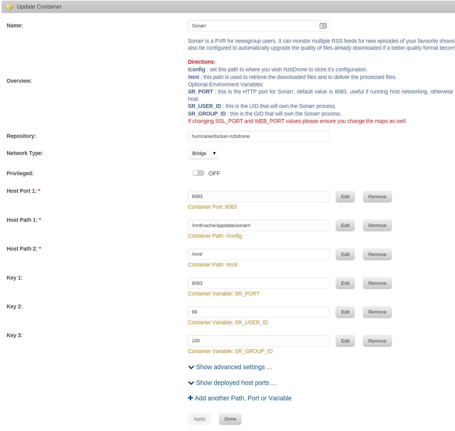

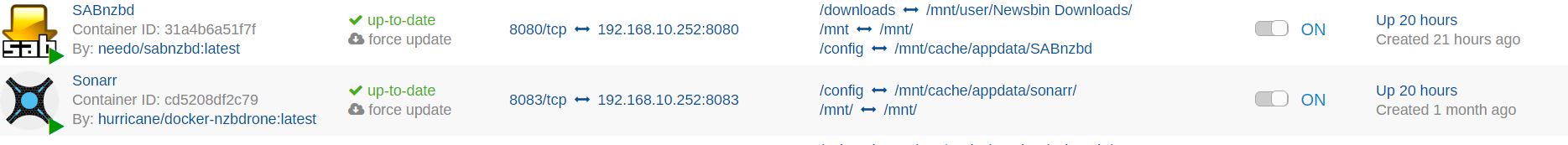

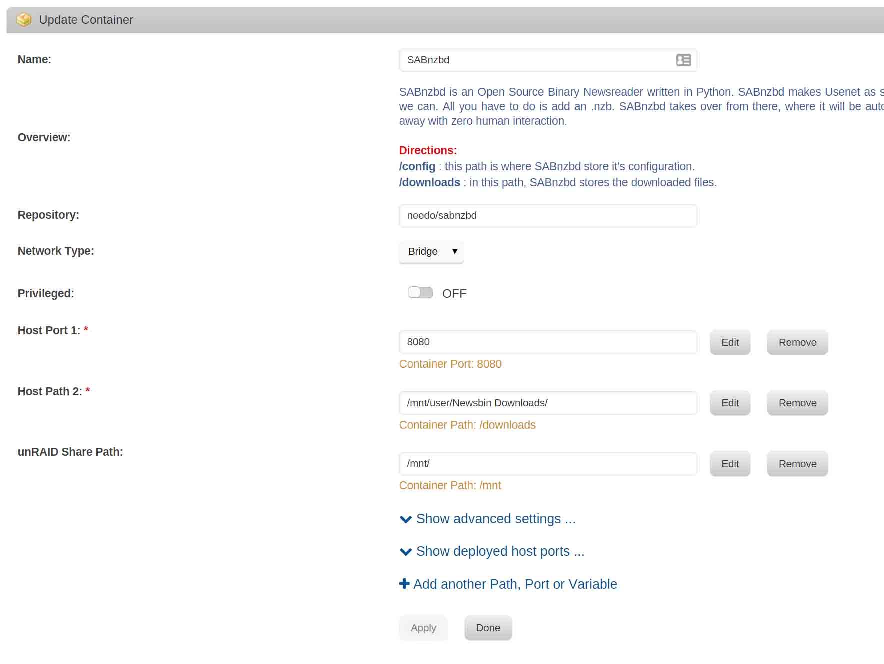

Docker mappings attached

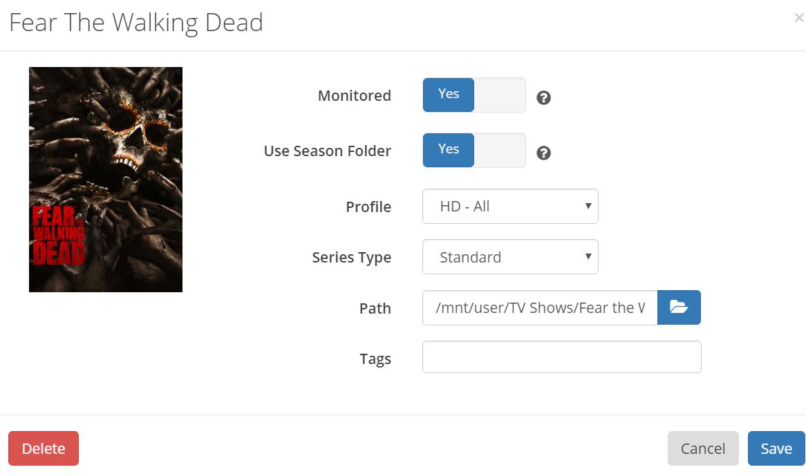

Post a screenshot of what appears when hit edit (the wrench) within Sonarr on one of those TV Shows that's currently being saved to the cache drive.

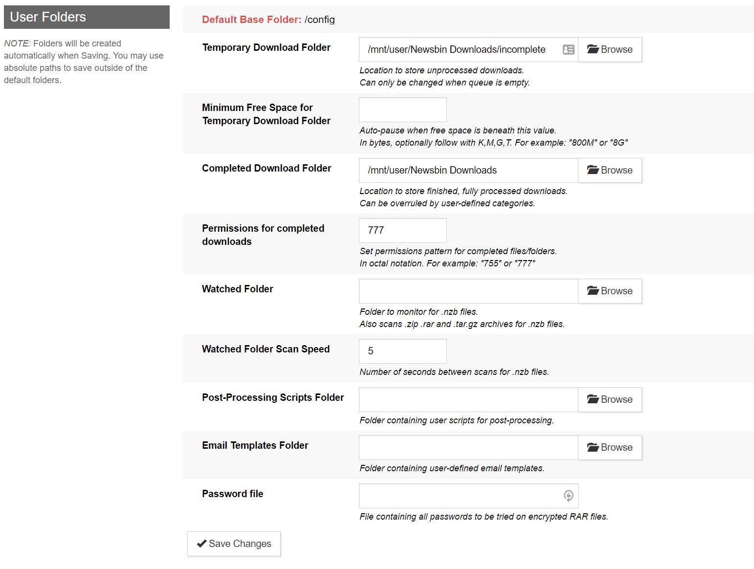

Don't use SAB, but post a screen shot of its folder settings of where its placing the files. (complete and incomplete)

Screenshots as requested, thanks

Post a screen shot of your docker folder mappings not the tcp port mappings.

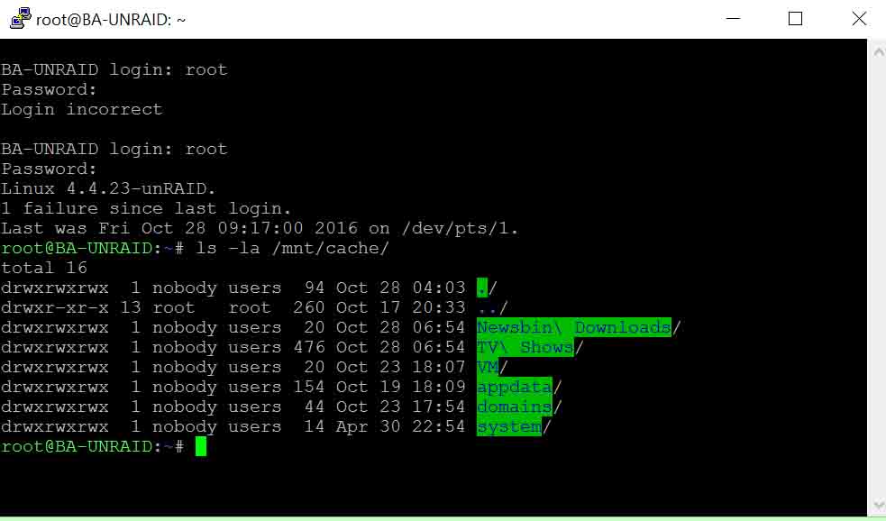

Also, post the output of this command:
ls -la /mnt/cache/
Thanks mr-hexen
Is the "TV Shows" folder on the cache drive empty?
ls -la /mnt/cache/TV\ Shows/
If YES, then you need to remove it via the command line using this command:
rmdir /mnt/cache/TV\ Shows/
If NO, Empty it properly (i.e. mover or manually), then see above "If YES".
Since this folder remains on the cache drive unRAID is including it in the user share, REGARDLESS of your setting in the share page.
