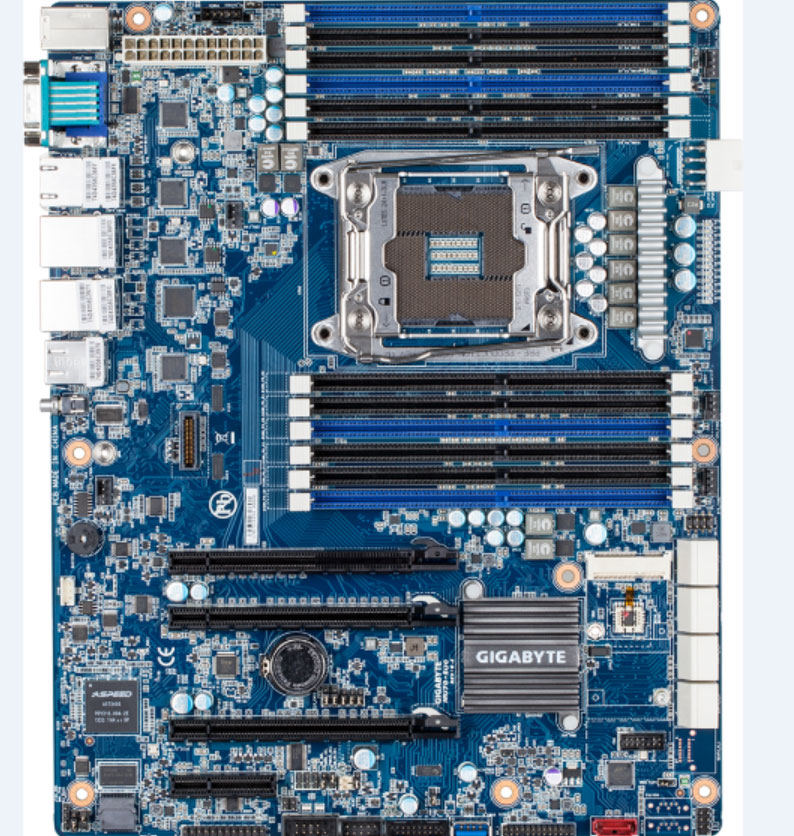

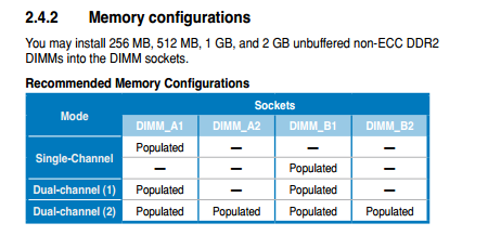

Your Ram configuration is odd. You do use 3 Sticks? Or are there more like in a Kit etc.? I know this is Not related that much but i know of very odd behaviour if Not all Channels of a cpu are used or uneven distributions are used.
Hi, yes I'm a bit of a nube, I thought I could use 3 because 24gb is plenty. They should only be used in pairs then right?
See attachment.. straight from your motherboard manual..
Well there is part of the problem, I have no idea what that table means?  :-[
Just use 2 RAM sticks and put them in the yellow slots.. if you buy another one, you can fill the other 2 slots..
Looks like you should be fine with the first 3 slots filled according to the manual..
1st three or the first three blue ones? I have no idea lol
In your picture the top 3 they should be labeled DIMM_P0_A0/DIMM_P0_A1/DIMM_P0_A2

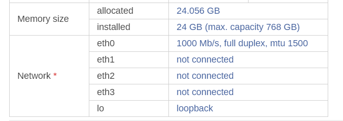

Could it be you're operating at Half Duplex on the network by negotiation? (Just throwing that in there)
hi,
I don't think so, here is what unRaid sees:
I just tried changing switches and that has no made any difference, same with cables.
Could it be the router?
Yes, it could be.  How is your network configured, i.e. what is plugged into what?
