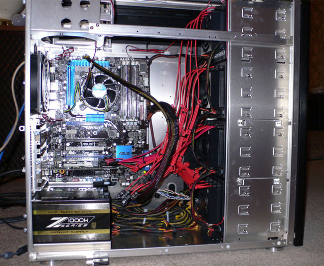

I’m having trouble with unRAID not being able to properly generate the flash GUID.  I purchased two preconfigured 2GB Lexar brand Flash drives containing unRAID Server OS Pro registration.  I’ve also tried the free basic 4.5.1 with a 1GB kingston Data Traveler and a 4GB Sony Micro Vault.  The MoBo is an ASUS P7P55 WS.

I’ve tried both USB ports directly on the MoBo and one directly to the back.  Also tried both preconfigured flash drives (got the two pack) plus two more I had.  All give the same GUID.  It’s a big rig w/ (4) 3x5 raid cages for (20) 2TB drives, so trying another MoBo is out because I need (4) PCI-e 16x slots for the SATA cards.  Not dealing with drives yet, I just need to get beyond the basic version (3) drive limit to paid for Pro working..Thanks.
