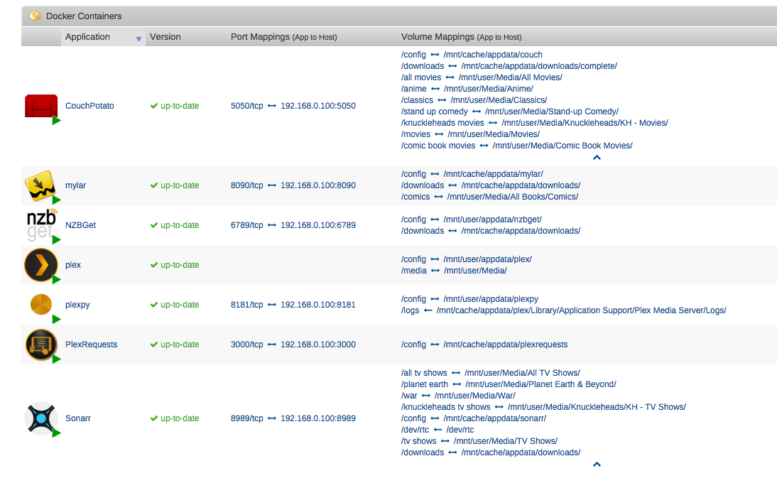

As far as the image filling up, you DO have a container misconfigured.  Probably either crash plan or a download client.    Post the screen shot of the docker page and we'll go from there
Sent from my SM-T560NU using Tapatalk
This was my previous set-up.  I have since located over 14 orphaned docker.img files, which I have now removed.

For instance, the MakeMKV-RDP container defaults to writing its output files to /nobody (inside the container) instead of /output. (The mounted output path.)
The volume mappings look OK, but I notice you often use lower and upper case letters differently in the mappings. Perhaps you have the applications using the wrong path when you set the application up.

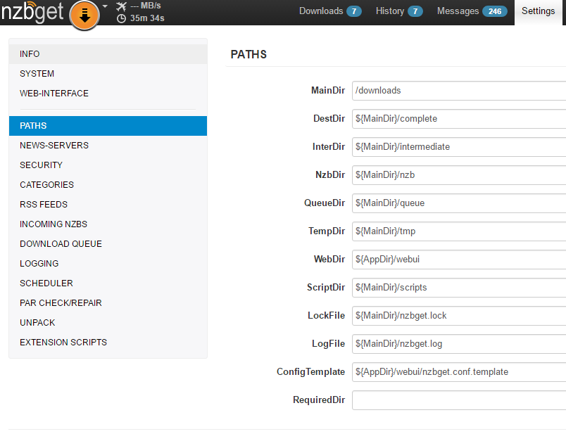

Post a screenshot of the Paths Settings in NZBGet, for example.
here you go
thanks
NZBGet looks OK. Plex is the only other one you have that I use and if it is working probably OK. Maybe CouchPotato or Sonarr, where you have a lot of paths.
