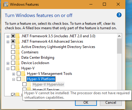

February 9, 20179 yr I think I solved it, with an additional note. I don't know if Buggy's post made a difference, but I'm guessing it did. However: I still couldn't install hyper-v through programs and features. Same message and greyed out as screenshot above. After a bit of googling and mumbling, I randomly stumbled on a microsoft link: https://docs.microsoft.com/en-us/virtualization/hyper-v-on-windows/quick-start/enable-hyper-v By random chance I just attempted the powershell command written there: Enable-WindowsOptionalFeature -Online -FeatureName Microsoft-Hyper-V -All And success, it installed hyper, rebooted twice and I now have Hyper-V Manager and everything installed. NB: I have not yet tried booting anything through it, so whether it works or just installed I can't say yet. I'm keeping my hopes high, will try during the weekend. I'll update this thread/post if I have success.

February 11, 20179 yr Just an FYI, enabling hyper-v enlightenments in a guest VM and being able to run Hyper-V inside a guest to create nested VMs are NOT the same thing. The Hyper-V setting available on the edit VM page refers to making the windows guest VM "aware" that it is a VM. This lets Windows relax a bit on things like clock timing and spin locks. Read this as: possibly better performance for the guest VM. What you guys want is to enable nested virtualization which will let you install VMs under a guest running on unRAID. That's was disabled by default in 6.3 due to stability concerns related to Avast (the antivirus software). Lastly, being able to use Hyper-V with Nvidia GPU pass through has been around since 6.2. We already automatically patch the VM XML for you, so those custom XML statements are not necessary. Sent from my SM-G930P using Tapatalk
February 11, 20179 yr Thanks for clarifying jonp However that still doesn't really bring us closer. I see now that when I disable the Hyper-V setting on a VM I get the Nvidia passthrough problem that has been mentioned. By just enabling it, the problem is gone, which also shows that Unraid is already "faking" the vendor_id (with the text "none"?) Bungy wrote: Nested virtualization was disabled in 6.3rc9 and 6.3stable. It can be re-enable by adding these lines to the top of your /boot/config/go script: <code> echo "options kvm-intel nested=1" > /etc/modprobe.d/kvm-intel.conf echo "options kvm-amd nested=1" > /etc/modprobe.d/kvm-amd.conf </code> However even with that I still can't install/run Hyper-V VMs. I do not run Avast or other such software, so I'm really not concerned there. How do we enable nested virtualization? Is Bungy's tip correct? Or is there something missing to reenable nested virtualization? Would I be forced to downgrade to a Beta release? Linux 4.9.7-unRAID. root@Tower:~# cat /etc/modprobe.d/kvm-intel.conf options kvm-intel nested=1
February 14, 20179 yr Found out that this issue is actually a bug in KVM: https://bugzilla.kernel.org/show_bug.cgi?id=106621 It will be fixed in the 4.10 kernel which is not yet stable. Probably something for 6.4.
February 14, 20179 yr Wow.. Thanks jonp Although that's bad news for me Guess I'll have to try to see if I can get my p2v converted through other means. Looking at release notes, it looks as I can expect 6.4 to be in the range of at least 3-6 months. At least thanks for finding that KVM bug, now I know the source of the frustration
February 17, 20179 yr I think my previous instructions may have been incorrect. I think we need to modify the kernel paramaters on boot to enable nested virtualization in unraid 6.3+. Modify /boot/syslinux/syslinux.cfg to append these parameters: append kvm-intel.nested=1 kvm-amd.nested=1 initrd=/bzroot instead of append initrd=/bzroot You can then check that nested virtualization is enabled using: cat /sys/module/kvm_intel/parameters/nested I'm sure the command is similar for amd machines.
