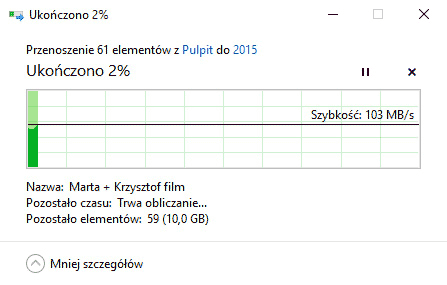

I have a problem with copying files to Unraid. At the beginning the speed is at around 100-110MB/s which is my max speed of the network, but after few gigs of data it drops to zero then it hovers around 30-40MB/s. I'm copying mostly large files. From SSD to SSD Cache. The example in the gif I attached is 10GB, where there are two 4.4GB files, two 400MB files, and few small files (less than 200MB in total, and those were copied at the very end). Same thing is happening on two Windows 10 machines.

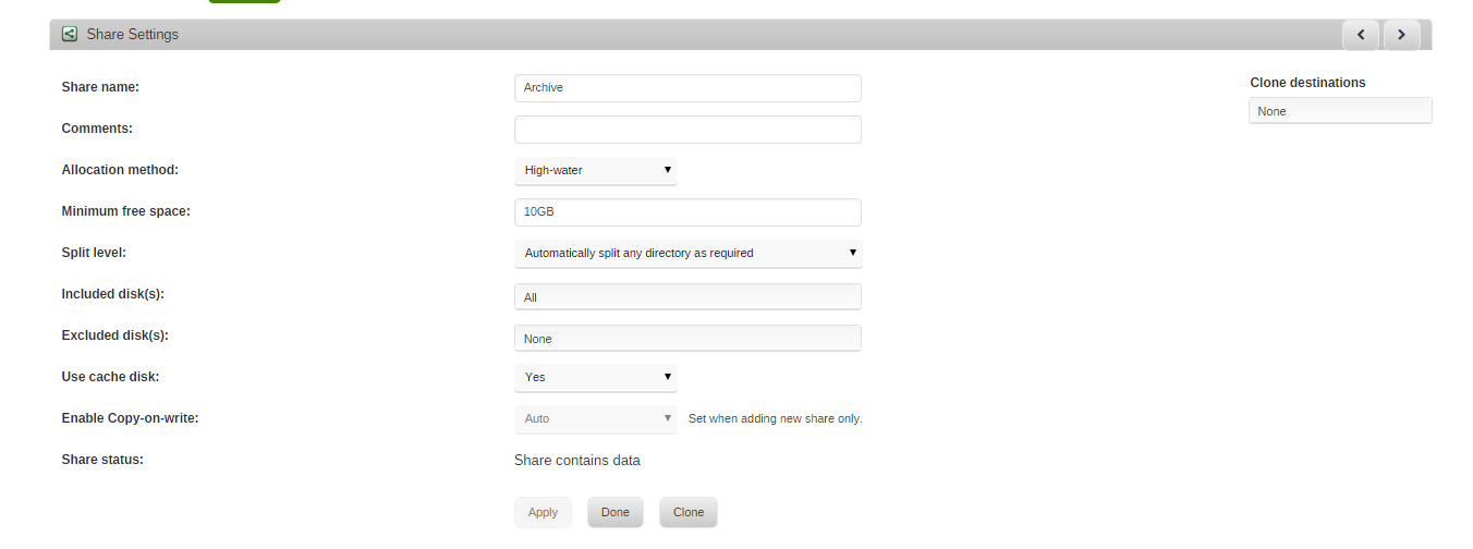

I have cache enabled for the share and after copying I can see that on cache disk there is 10GB Used.

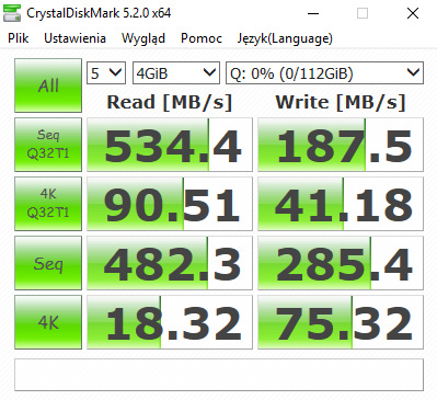

I've attached the SSD benchmark. I thought that in this application sequential writes is what is importnat. Am I wrong?

Benchmarks and real usage speeds are often different, although I would expect that SSD to be able to sustain writes close to 100MB/s.

I think this might be the SLC / TLC caching of the drive. A 120GB SSD will have a smaller write cache and I understand the SP580 doesn't have any onboard DRAM. This might be normal behaviour for this SSD for sequential writes.
OK, so I returned the Adata 120GB SSD and bought Samsung 850 EVO 250GB and the problem is solved.
