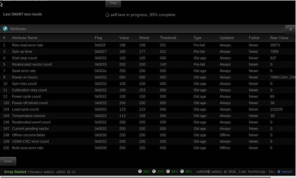

[*]At this point, I went ahead and bounced my server from the command line and proceeded to perform the recommendation from Fix Common Problems and run a SMART test which is currently stuck at 90% after over 14hours; however, I ran a quick SMART prior to the extended which reported no errors.

1.  Should I wait for the extended SMART test to complete and how long should I expect to wait for the test to complete on a 4TB WD drive?
2.  Should I suspect imminent drive failure at this point? I've ordered a replacement WD Red NAS drive just in case?
3.  What are some other areas I should check that may be causing these errors in order to rule out possible drive failure? The drive has been in operation for less than one year.  This point may be moot, but i still wanted to mention.

SMART test run on the disk itself finally finished but reported no errors.
