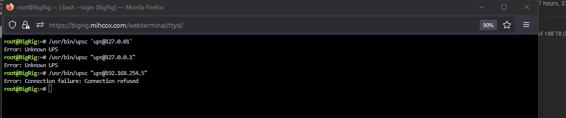

right, i see that file in the plugin code, doesn't seem to be used elsewhere though, however i havent looked too deep
still, the code does look for the main config at /boot/config/plugins/nut-dw/nut.cfg
i understand /boot/config/plugins/nut-dw/nut.cfg doesn't exist in your system right ?
the other 2 commands i sent you, are they throwing the same error as the initial one ?
with single quotes
/usr/bin/upsc '[email protected]'
with double quotes
/usr/bin/upsc "[email protected]"
thanks for the help in troubleshooting, hopefully we can get to the bottom of it :)
Edited by jbrodriguez

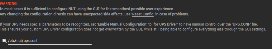

ah, now the purpose of /etc/nut/ups.conf is clearer
i assume the web interface for the nut plugin does show the ups info correctly right ?
its strange though that the /usr/bin/upsc command is still failing
i think it's failing because of the "ups" name ...
is there a name entry in your /etc/nut/ups.conf file ?
if there is, does it work when you replace it in the command ?
/usr/bin/upsc "<name from /etc/nut/ups.conf>@192.168.254.5"
if the name is the top part in the box, yes.
root@BigRig:~# /usr/bin/upsc "[email protected]"
Error: Connection failure: Connection refused

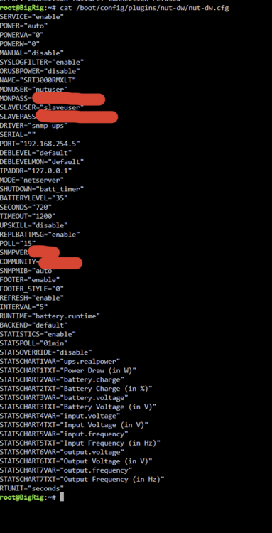

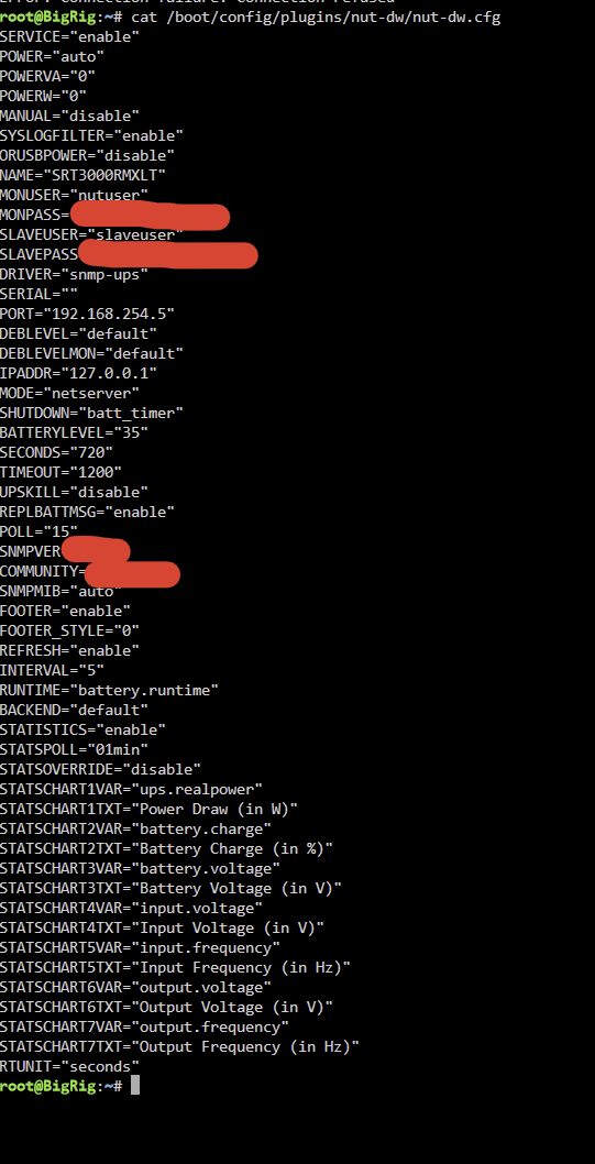

actually, im rereading the code and the config file is at /boot/config/plugins/nut-dw/nut-dw.cfg
do you have that file ?
aaahhh finally, the config file !!!
ill publish the plugin pointing to the correct location of the config file, but im not sure that will solve your specific case
ill look into it this weekend, i have more info now
thank you !!!

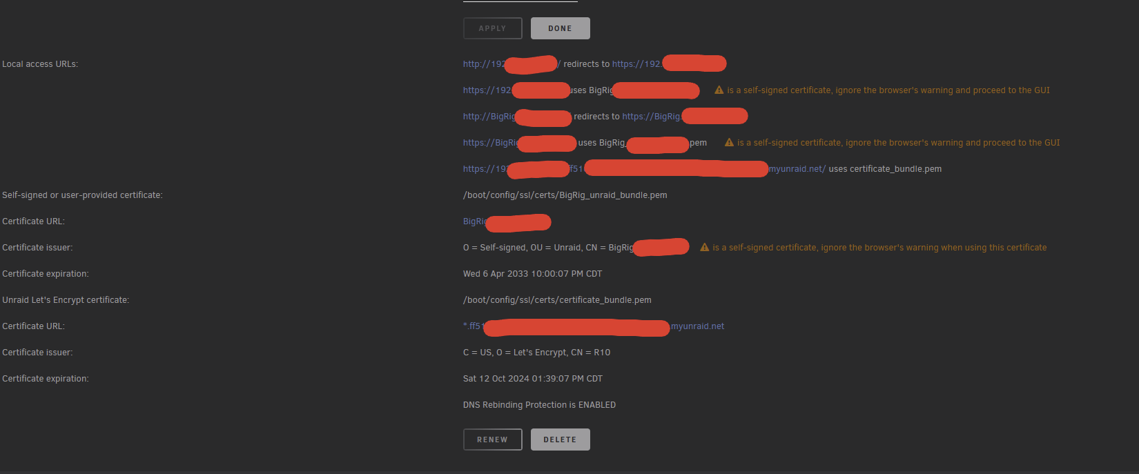

so which of the following am i supposed to use? image.thumb.png.6fac82babcc383e5ddeeef8de5ada15c.png
The my myunraid.net one works for me.
the one that ends in myunraid.net, as wgstarks mentioned
