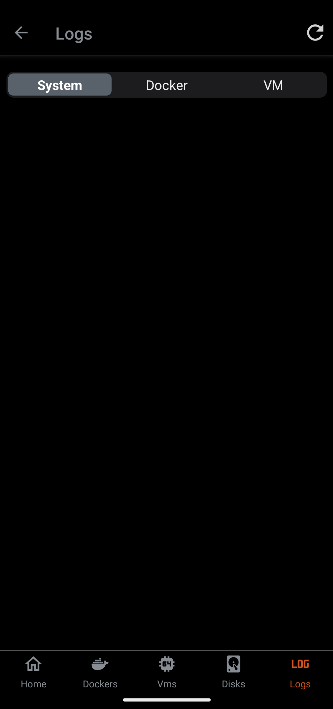

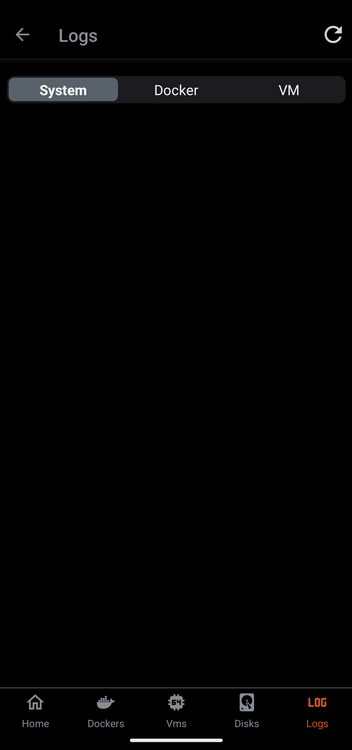

— The scan qr code does not work, it gives error. I did manual add server and that works fine. 😐
— Logs don't work in my case on the android app not sure what's up with those. 😕
Edit: Found the logs (for the logs not working 🤣) in case they help you :)
re: 1,2, awesome !!!
re: 3, yea, i released a new version of the app and a new version of the plugin, hopefully this fixes the qr code :)
re: 4, well, i completely forgot about logs !!! thanks for pointing that out, i'll add them back :)

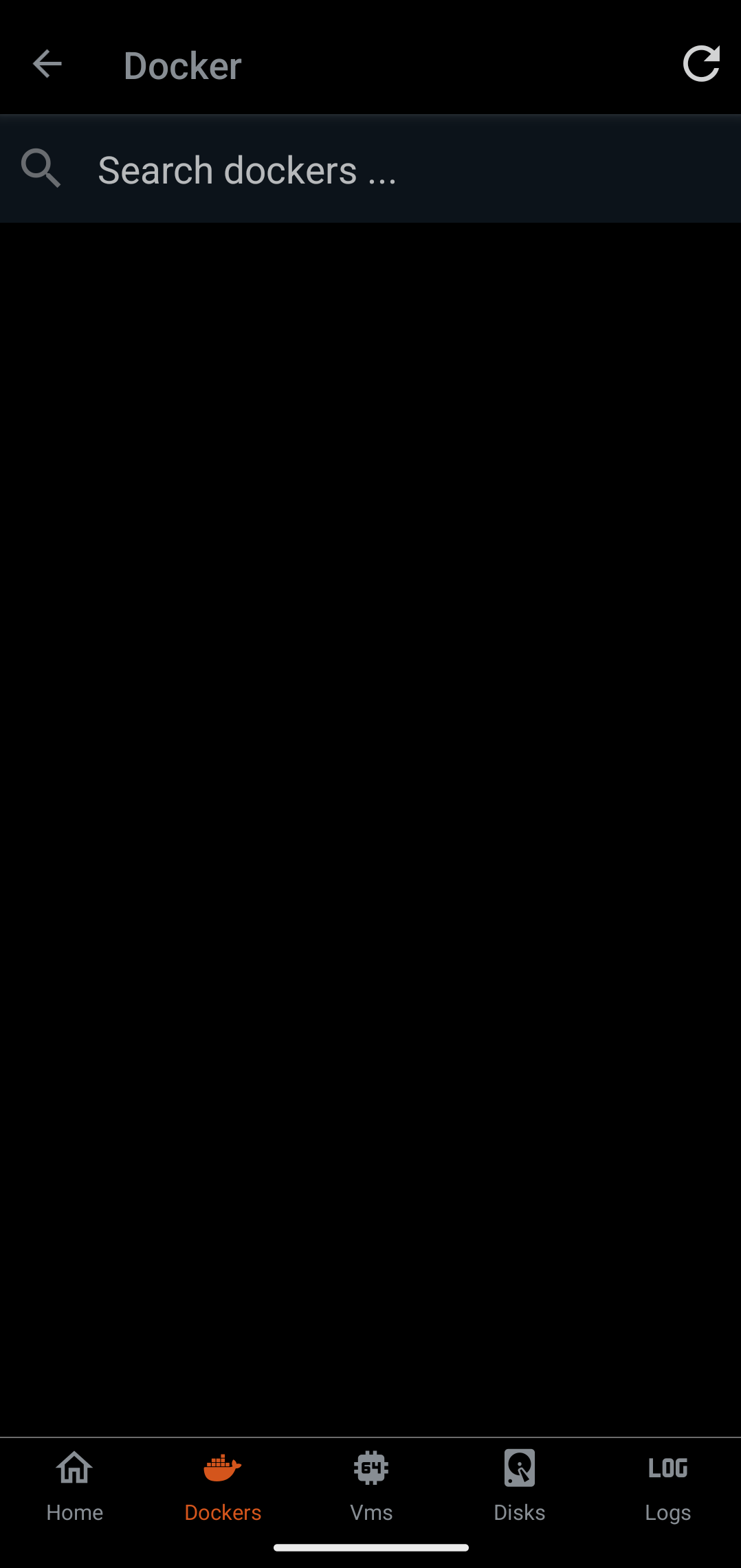

hi,
scanning qr code from plugin does not work.
import and manual work on android app.
docker,vm and logs dont work.
Edited by cyberspice
logs added
cool that import and manual are working
about qrcode, can you make sure you're running on the latest 6.7.1 version (and latest controlrd plugin) ?
the errors you see in the log are related to the docker, vm, system, which i haven't implemented (forgot about it 😢), will work on it this week

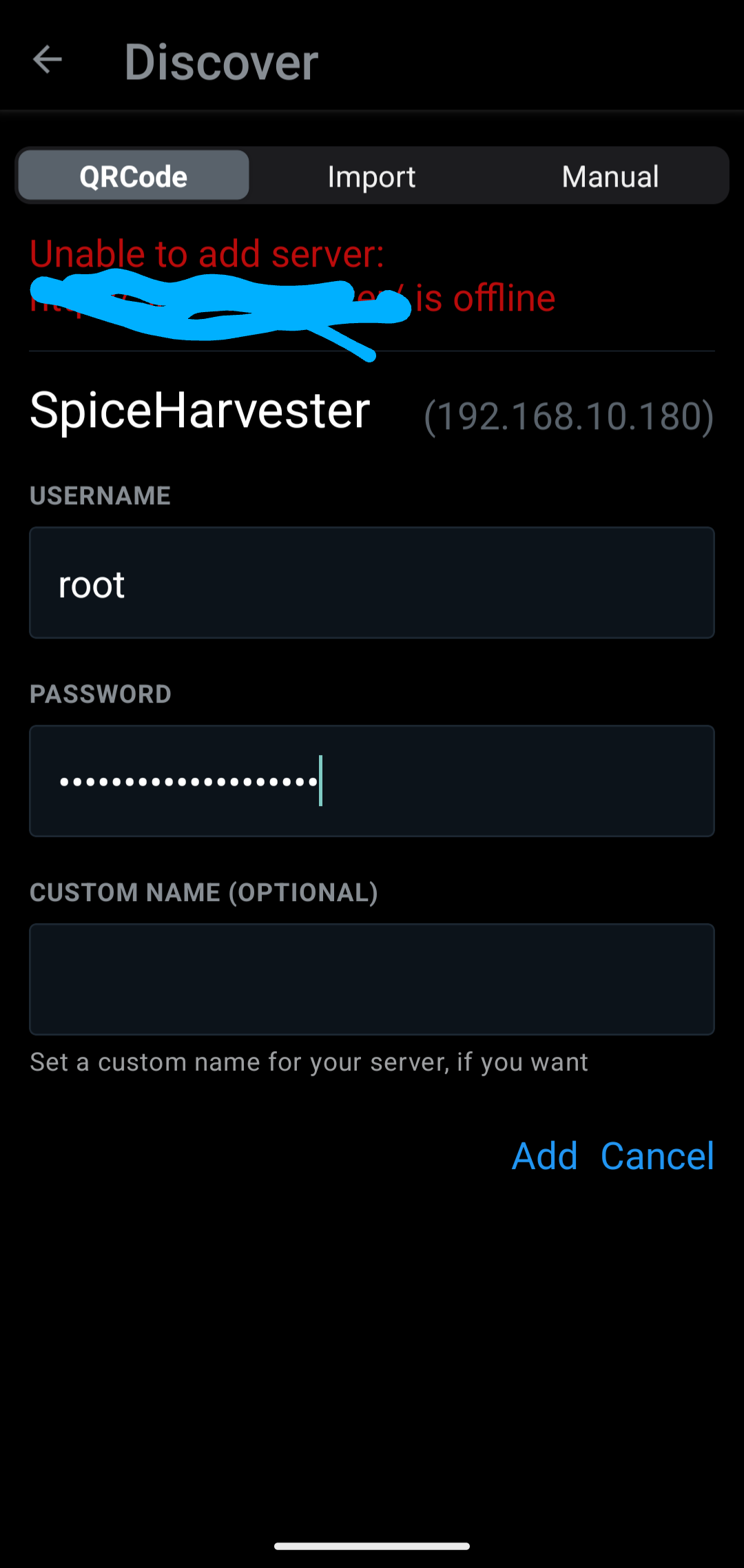

On 9/3/2024 at 4:08 AM, jbrodriguez said:
can you show the error ? also, can you make sure you have the latest app version (6.7.1) and latest controlrd plugin version
“Unable to add server: https://
192-168-43-10.REDACTED.myunraid.net:444/ is offline”
Port 444 is correct as I have SWAG running on 443
controlrd version 2024.09.03
App version 6.8.0
Edited by canadrian
i see, can you try accessing that URL from your mobile device's browser ? does it work ?
Screenshot attached.
Out of curiosity, how is it supposed to work? How is it supposed to resolve DNS for example?
what happens is that the *.myunraid.net hostname gets resolved to an ip, just basic dns, the difference is that this gets resolved to a private address ip (192.168.x.x, 10.x.x.x)
i had the same issue as you, i solved it by whitelisting the myunraid.net domain in the rebind protection feature of my firewall
do you have a firewall where you can whitelist rebind domains ?
Hi @jbrodriguez,
Having the issue now, where docker and VMs don't show up in the app. Relevant server logs -
Sep  7 02:27:42 Tower sudo:     root : PWD=/usr/local/emhttp ; USER=root ; COMMAND=/usr/bin/bash -c '/usr/local/emhttp/plugins/controlrd/controlrd --show-ups'
Sep  7 02:27:42 Tower sudo: pam_unix(sudo:session): session opened for user root(uid=0) by (uid=0)
Sep  7 02:27:49 Tower root: error: //webGui/include/ProcessStatus.php: missing csrf_token

1 minute ago, Unraid-arr said:
Hi @jbrodriguez,
I hope it is something minor.
Thanks
they were showing with the latest app/controlrd plugin and suddendly disappeared ?
the missing csrf_token is not an issue, it just tells wether the server is up or down
in any case can you provide me some troubleshooting data from your server ? if yes, pls follow the instructions on this page https://github.com/jbrodriguez/controlr-support
I have done this. Had to provide the port as well. :) with URL.
Cannot copy the email from your link to send. Hope it reached you. 🤣
