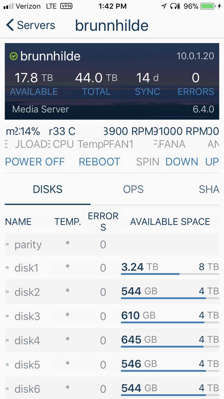

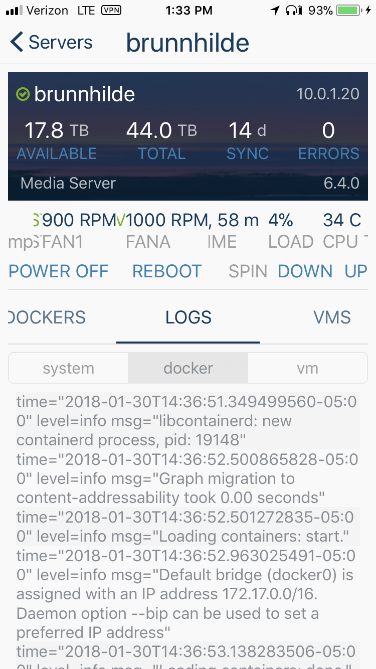

Looks Like the scroll is running in two directions. Not sure how well it will show in this screenshot, but there are two identical scroll bars (one foreground and one background) scrolling at different speeds and bouncing left and right. What a trip.?
Here’s another screenshot that maybe shows it better.
It’s actually a very cool effect in the right ummm frame of mind.
Restarted the ControlR app on my phone and everything is good now. ?
Looks like the server is pulling the readings I have configured for the webUI footer.
:D
O.o
It should reconfigure the scrolling ticker with the new readings, but it doesn't work :D
The restart gives it a fresh view on the matter.
In any case, it's great news !!
