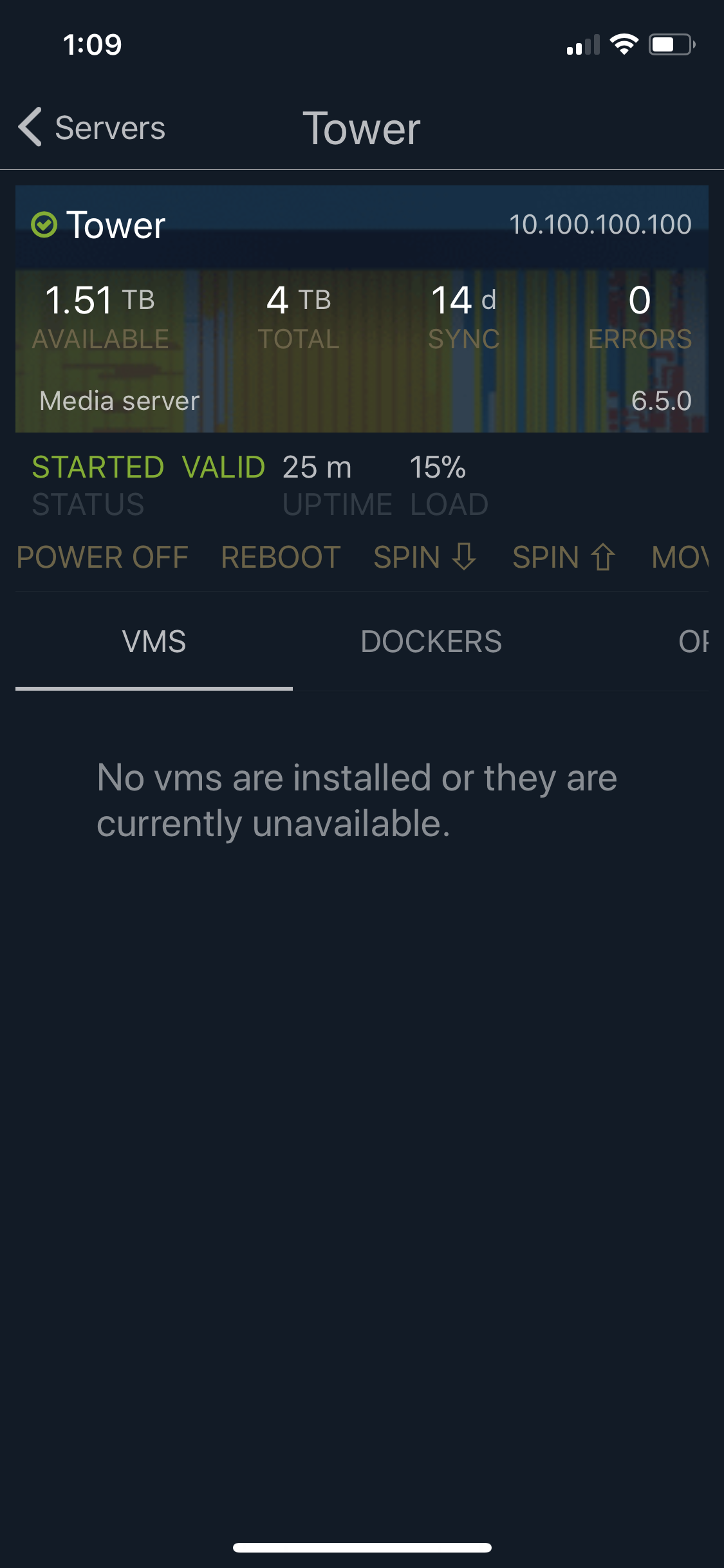

I am running ControlIR 2.9.1 and upgraded (from ver 6.4.0) to Unraid 6.5.0 today on one of my Unraid servers and I am no longer to see the running Dockers or VM's on my android app (S8+ - running Oreo),I just see the message 'No dockers are installed or they are currently unavailable.    If I connect to another server (running version 6.4.0), I can see the Dockers/VM's without issue.
Any suggestions on how to resolve?
Thanks.

Im getting “No Dockers are installed” when I try to access them via the Controlr app. Not exactly sure when this started. Possibly when I updated the OS to 6.5.0.
controlr.log
Thanks for the log wgstarks.
I don't see anything out of the ordinary.
Let me upgrade to 6.5.0 on my test server and see how it goes.
remati/wgstarks, let me figure this out.
