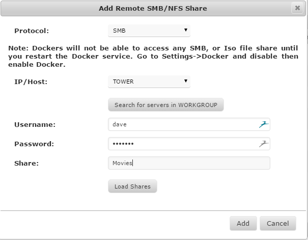

Thanks to everyone who has replied its much apreciated  ;)
I have installed "unassigned devices" no problem there  :)
My unraid box which has my shares \\TOWER\Media\Movies\
                                                        \\TOWER\Media\TVShows\
                                                        \\TOWER\Media\Music\
I'm having no luck mounting the shares in my Plex Docker. I just see an empty folder in plex.
Can anyone post some screenshots of there "add remote smb nfs shares" settings and docker settings?  ;)
It is very confusing trying to fill in the correct mount paths etc when i dont completely understand  :(
I do understand  i have to mount a remote smb share then fill in the mount path into the plex docker settings. i'm just not sure if i am filling in the correct information. (very frustrating) LOL.
Any help would be apreciated.

Thanks Squid for replying  :)
I've taken some screenshots of what i'm doing.
Adding SMB Share
Mounted Share (don't know if its mounted or not?)
Docker Config (don't know if this is correct)
Container settings
Plex Container
Plex Empty Movies folder
Would you mind looking over these screen shots for me please, and see if im going wrong somewhere.
Thanks Alot  :)
Everything is right.  But you still have to hit mount on the UD screen.  And then probably restart plex

Ok. I feel a bit stupid right now  :o
The problem i have discovered was that both my unraid box's were named "Tower" and this would not allow me to mount shares from my other unraid server.
Thanks for all your help guys especially Squid  ;)

Sounds like your sorted now. As squid pointed out you have press the mount button after setting up the mounts, also both machines must have unique names.
Also I noticed you also have the varible "plexpass" in key 3 this no longer works and to keep it up to date it must have "latest" assuming you are you ls.io plex
The problem i was having, was pressing the mount button would not mount the share. All because the two unraid servers had the same name  :o.

uhmm.. isnt the remote share "media" not "movies" ???
