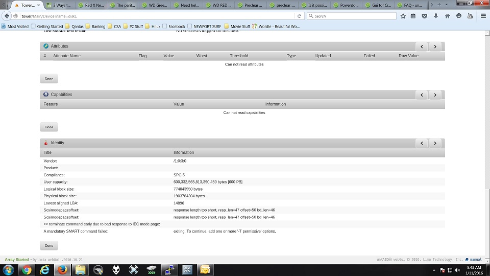

I did the parity swap, but now disk 1 is down....see diagnostics...haven't shut the server down yet.....bugger
The disk in question is WDC_WD20EARS-00MVWB0_WD-WMAZA0523138-20161101-1916 during the parity swap/check it came back millions of errors
This is the error message on the Disk1 page    scsiModePageOffset: response length too short, resp_len=47 offset=50 bd_len=46

Parity copy completed successfully but disk1 dropped out a couple of hours after the rebuild of disk2 started, so disk2 needs to be rebuilt again.
Looks like disk1 timed out, eventually making the SASLP crash, so I would start by powering down, reseating that controller, check cables to disk1, power up and post new diags so we can see SMART for disk1 and decide best way to proceed.

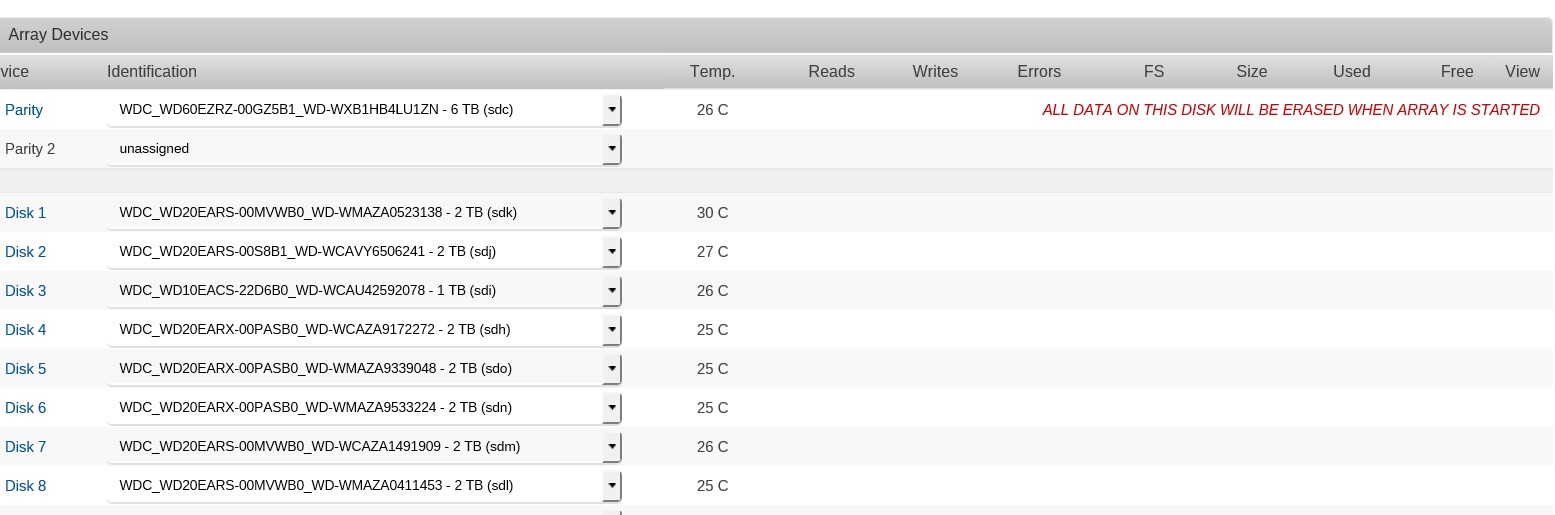

Ok...Ive done the following
-printed a screenshot of all assignments
-stopped the array
-tools -> new config -> Retain array configuration: ->  select "all" -> check "Yes I want to do this" -> Apply
-on the main page change the assigned disk2 to the old disk WDC_WD20EARS-00S8B1_WD-WCAVY6506241
-remaining assignments as they are, including new parity
-before starting the array check "parity is already valid"
however there is still a message next to the parity disk that "all data on this disk will be erased when array is started"
Do I still go ahead and start the array? will it start a parity sync straight away?
That is normal, but if "parity is already valid" is checked it will not be rebuilt, you can start the array.
Yep cool....50% into the rebuild...I did option 2...after checking the contents of Disk 1, it all looked good, I stopped the array, re-assigned Disk 1 with my old parity disk to rebuild onto, restarted the array and it started rebuilding but Disk 1 has an orange triangle next to it(with 'device contents emulated' when hovered over) but it seems to be being written to and there are no errors being recorded...fingers crossed the orange triangle disappears after it's finished?

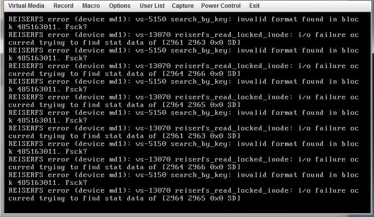

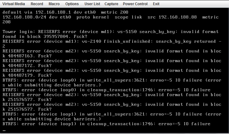

It turned to green and seems to be working however I'm getting this REISERFS error(see screenshot attachment)
Have attached diagnostics too
