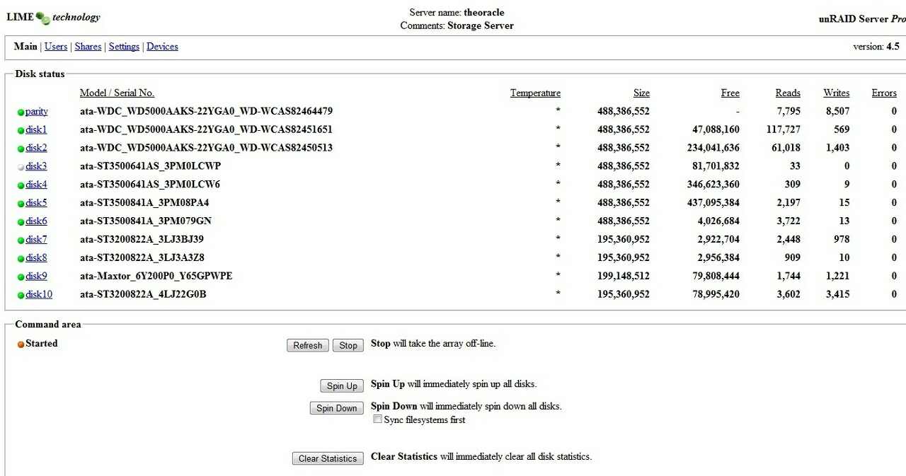

I have a 500gig drive that has reported write errors (4) and has been taken offline by unRAID.
I wish to replace it with a 2TB and also replace the parity drive with a 2TB (WD Green) - so I have two new 2TB drives I wish to install into my unRAID.
Per instructions this is what I am planning to - just wanted to check with you experts appreciate the feedback.
1. Are these the correct steps?
2. Is there anything else I should do?
3. Is there a way I can replace the parity drive with 2TB and the failed drive with 2TB without this intermediate step of swapping the parity drive to be a data drive? ie: end up with 2TB in the array and 1 bad and 1 good 500gig drives that I take out of the array.
Before doing any of this I am running extensive tests on the new 2TB drives to make sure they are good. Have been having some bad luck with WD drives lately.

The bad drive is disk 3 in the attached image.

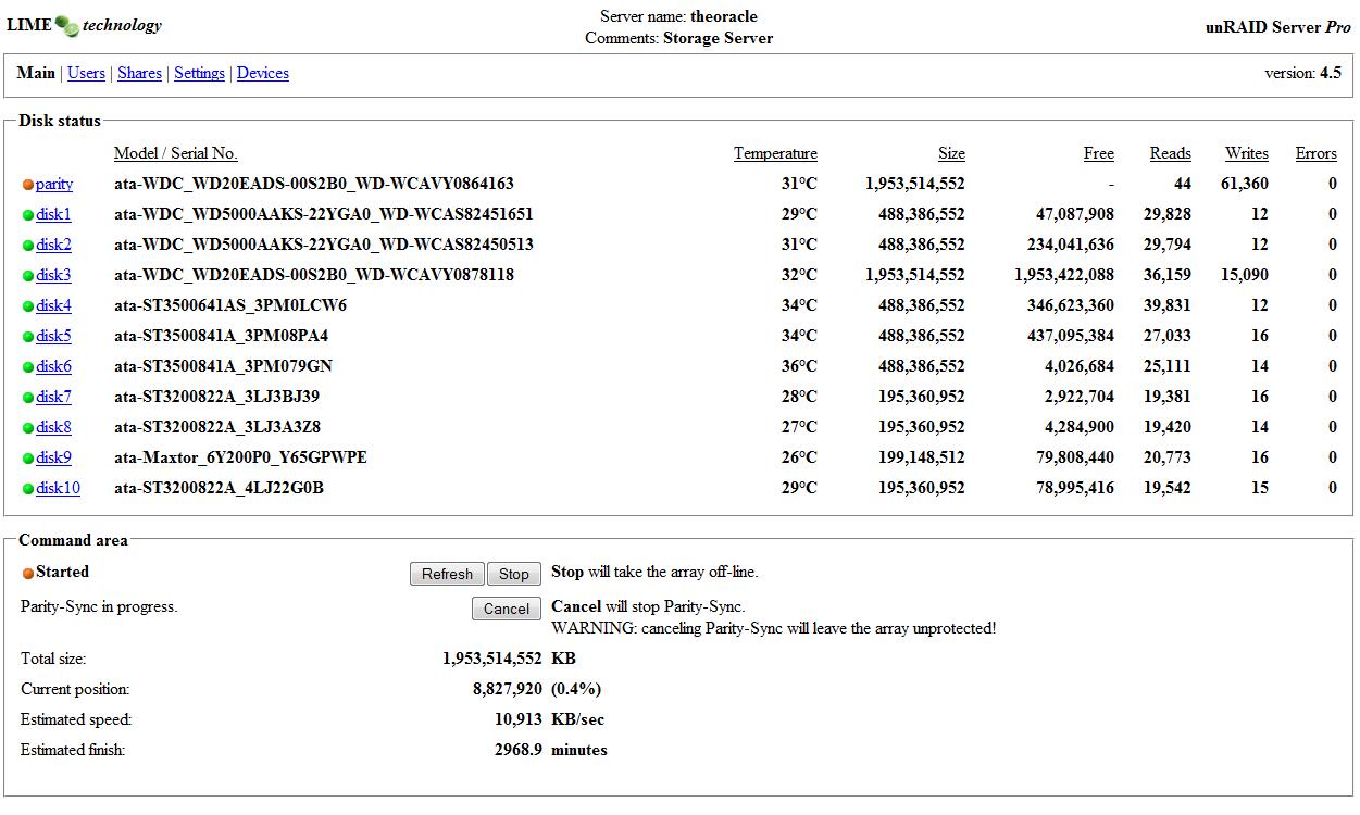

YES! Format complete Parity sync going on but look how long it shows for estimated finish! 2968.9 minutes! Thats 49 hours! 2 days for a synch.
I guess I took a major performance hit eh guys? 10 hrs to 2 days for a a sync anything I can do other than get a new motherboard?
See attached for new config and I still have 2x500 gig SATA's in hand! Hmmm what to do what to do... ;) save up for a new motherboard thats what!

It won't take anywhere near that time.  That would be the time if all your drives were the same size.  Since most are smaller, the rate will increase dramatically once parity is past the size of the smaller drives.

You are right it didnt take 2 days. Took about 12 ~ 14hrs. Not bad.
